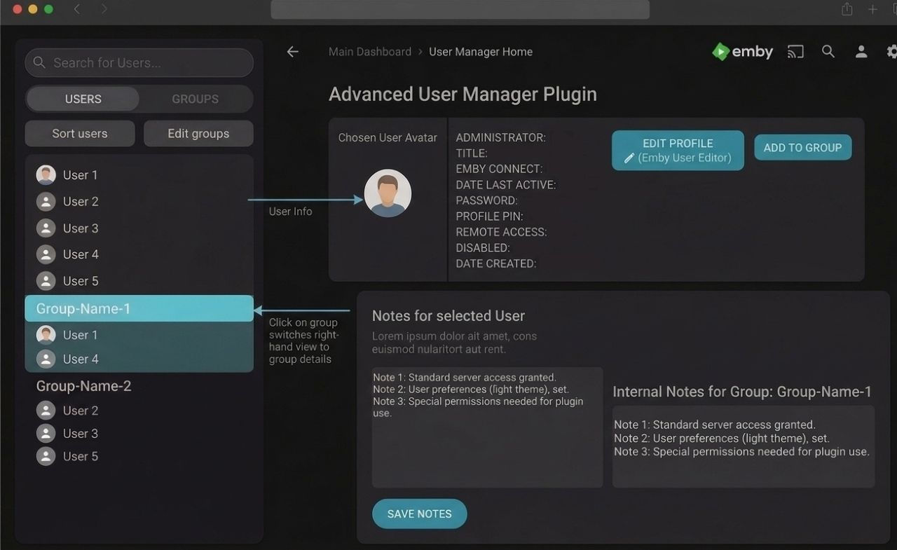

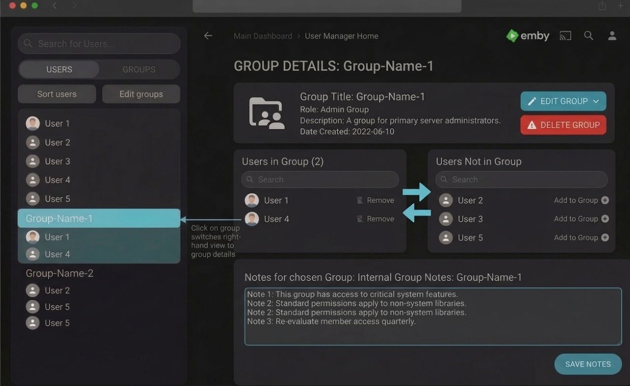

Have an "Admin Notes" section under each user account
SoliFlix replied to bennymac's topic in Feature Requests
If the admins don't implement this natively, I could try to create a plugin for it – here are some AI-generated mockups of what I think it could look like. -
