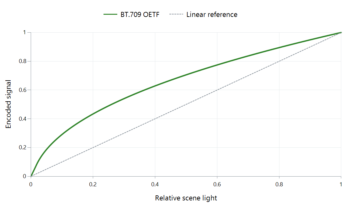

    A camera measures light, but the video signal usually represents it nonlinearly. An opto-electronic transfer function, or OETF, supplies that light-to-signal relationship. The BT.709 reference below assigns more signal space to low scene-light levels than a straight linear encoding would.
    BT.709 OETF compared with a straight linear encoding.
    Normalized scene light becomes a normalized video signal. Neither axis is a raw sensor code or an absolute number of nits.
