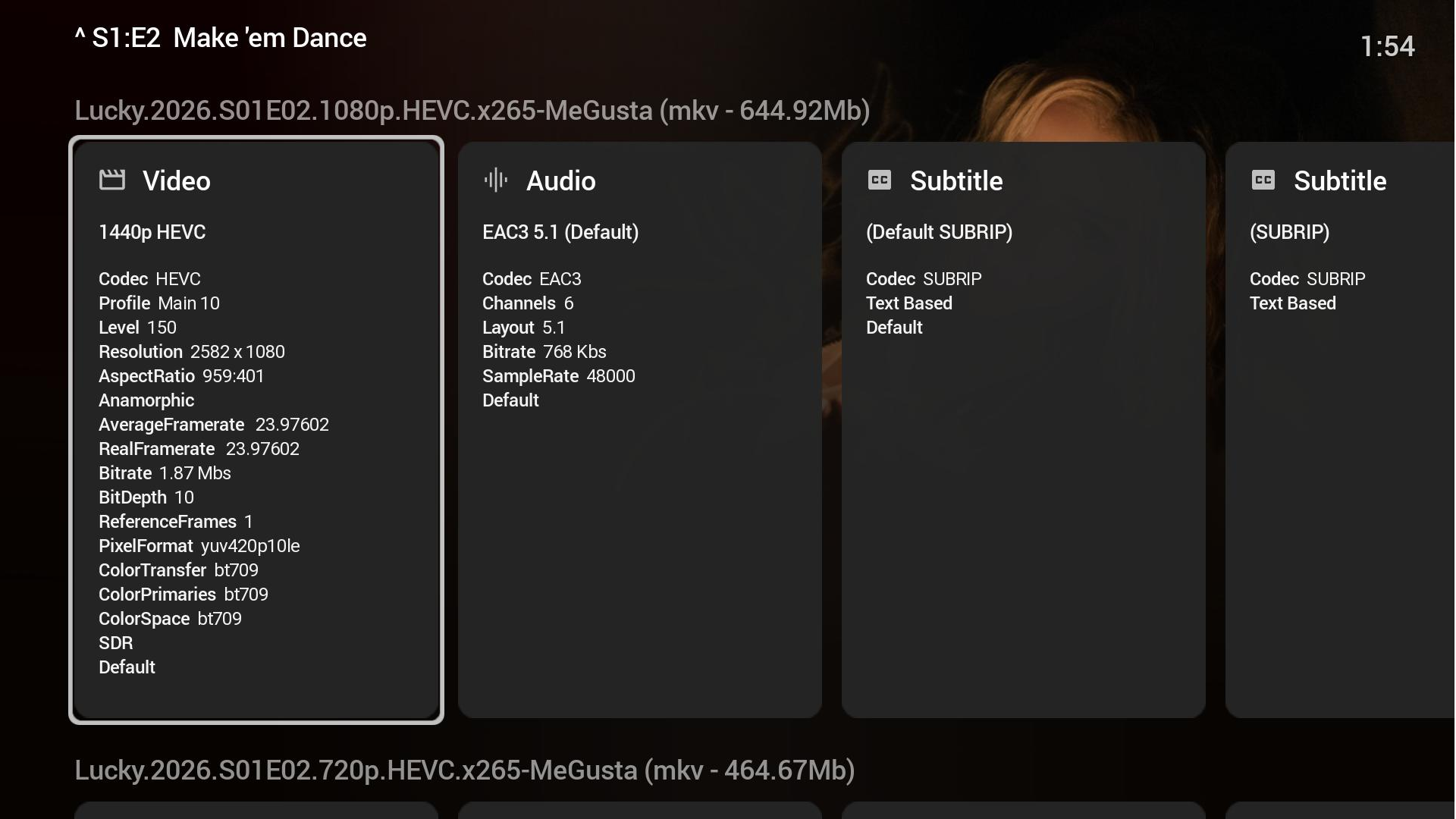

I tried out on my Onn Pro tv box & it kept pausing at 8 seconds and not doing anything else
Sooo, is this something for me to fix or…. lol

Here is media info for the same item from one in my collection. By looking at the metadata of their file I see that I have one in the same series with the same exact issue. Roku Streaming Stick 2025 HD Roku Streaming Device with Voice Remote: Wi-Fi, HDMI, 1080p It is only a 1080P device. The encoder (person who made this copy) for some reason made this into a super wide-screen edition. On 4K Roku devices this is okay. It will be able to tolerate the fact the width is larger than 1920. But with a Roku that is only HD this present an issue. You can only go a maximum of 1920x1080 with playback. @Luke We sent this with our request. We have a maximum display panel of 1920 width and 1080 height. But if you look below this isn't being respected. The server is sending us the full 2582x1080 resolution. This cannot work on these Roku models. They must only be given a maximum width of 1920 and a maximum height of 1080. We send this in our request. Because the server is sending the resolution too large over and over is causing the problem here. It isn't because of the EAC3 issue I thought at first. The EAC3 error happens when user error causes the problem by disallow the server to transcode audio. A valid reason to not have a valid stream. In this case the error stems from the inability to play the video that is larger than supported. This is obviously a bug in the server. We cannot fix this on the Roku side. Thanks.

digging around. i realized the issue im experiencing are files with the classification of just EAC3 5.1, i have another show Maximum Pleasure Guaranteed and the audio codec on them are specified as English EAC3 5.1 and they play fine. wonder if there's something there.
