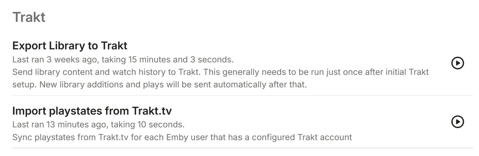

    Trakt plugin Scheduled Task fails
    No more immediate crash, but I believe it is fair to say the query/match being used is a swing and a miss but only for TV. Movies looks good. So here is a log snippet with debug tuned on that shows the Movies working, and the TV not. Just to be clear, it does not work for a single TV show, not one. But progress.... no crash. The task completed
