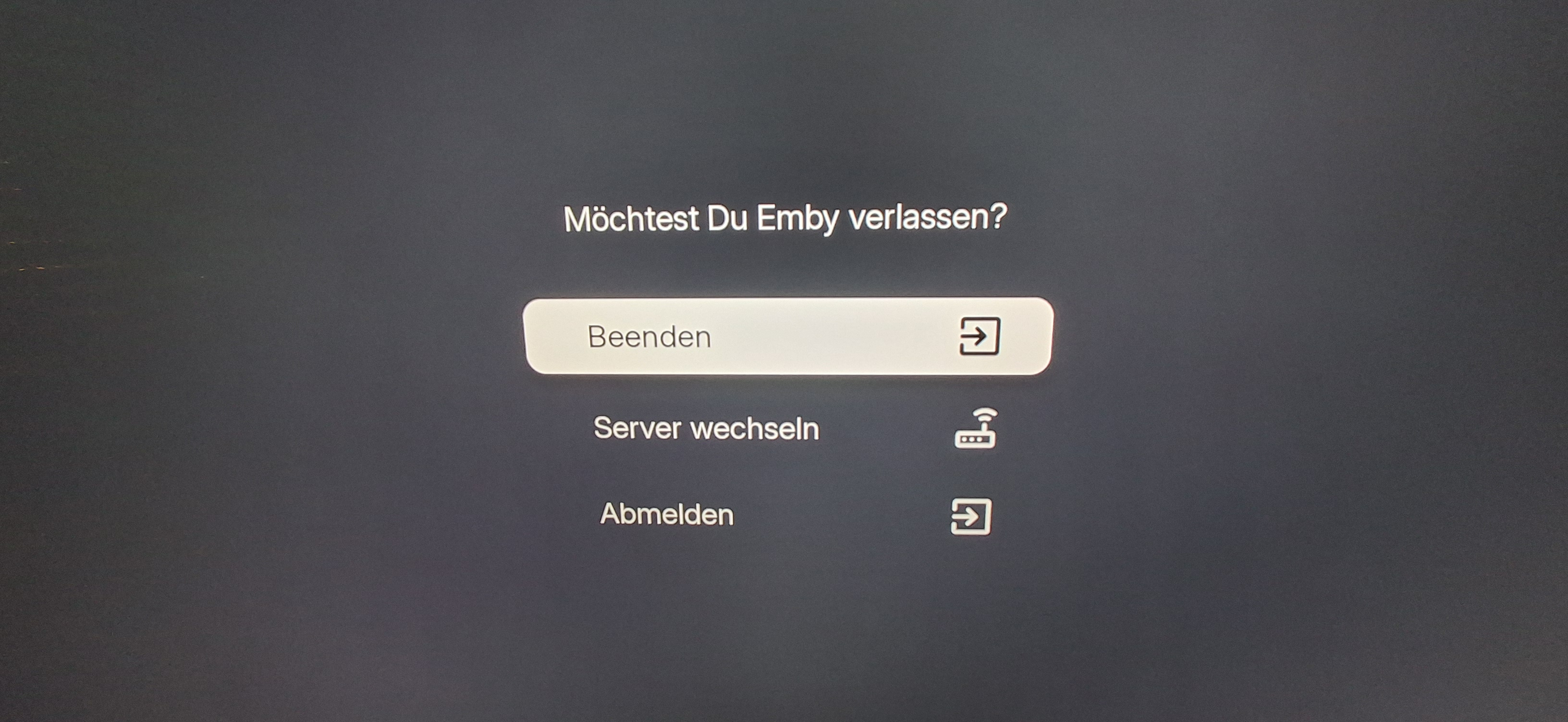

After loading the app and connecting to the server the screen attached pops up. No matter what I am choosing from there it directly returns to the same screen. Also there is no possibility to uninstall the app or reenter anything else either.
