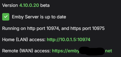

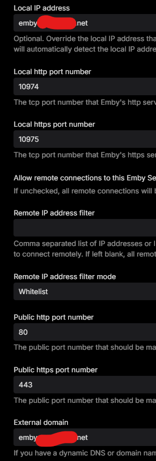

How to prevent apps from discovering/preferring "local"/LAN IP of server.
Napsterbater replied to Napsterbater's topic in General/Windows
That is strange, because that has never been my experience. Never had to block the clients on the local firewall to prevent this. So for the devs: If nothing changed, then why would clients previously setup with just the FQDN + Port 443, who could always connect direct in this manner but didn't, and always used the FQDN for everything, just now decided to stop doing that? Settings screen and dashboard have been set and looked like this for years. Also, again, the IP address reported for these clients has been their IPv6 addresses, and seemingly, Emby ONLY give the clients the IPv4 for the "Local Access" IP, plus seeing them on HTTP vs HTTPS as they have always been. -
Lessaj replied to Napsterbater's topic in General/Windows
Always been like that. I don't use emby connect, I have a domain. -
@LessajWhen did this start for you? Again for me it started roughly within the last month. Up until then the Apps always used the FQDN as* inputted on the setup screen of the app, for these I don't use Emby connect. -
Hi. Can you try searching for our standard android app (Just "Emby" on Amazon and "Emby for Android on Google) on the same device's app store and see how that compares? Thanks.
Something has absolutely has had to change, because up until the past month or so my apps never connected to the local IP. Because the IP reported by the Emby server itself in current streaming sessions shows this has to be the case. And no it's not due to X-Forwaded headers or anything, because that wouldn't match it either. They always utilized the IP associated with the DNS FQDN that I initially input to connect them with. And now they don't. They ignore it. They use the local IP and they're using HTTP vs HTTPs. I've had to resort to blocking via local Firewall So clients cannot access the server directly, and only the reverse proxy and or cloudflare tunnel apps can. That's never had to happen before. And Emby Network settings haven't changed for a couple years at this point. And this also happened on multiple Android apps, across a fire stick, Onn Google TV stock, And Android phone. Two different networks. One network is actually in a completely different subnet across the VPN tunnel, so it couldn't even have seen the local broadcast Discovery mechanism that's in place either Edit: Also as I noted, The local IP address I've always had configured on the network settings page in Emby, it was this FQDN, not an IP. And again that FQDN does not resolve to the local IP/s of the Emby Server. -
