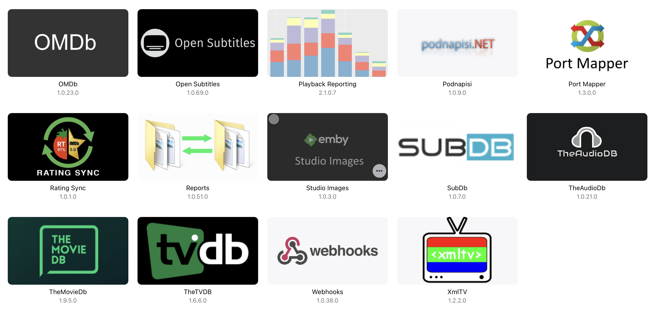

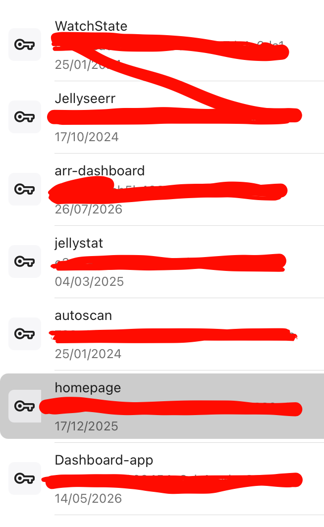

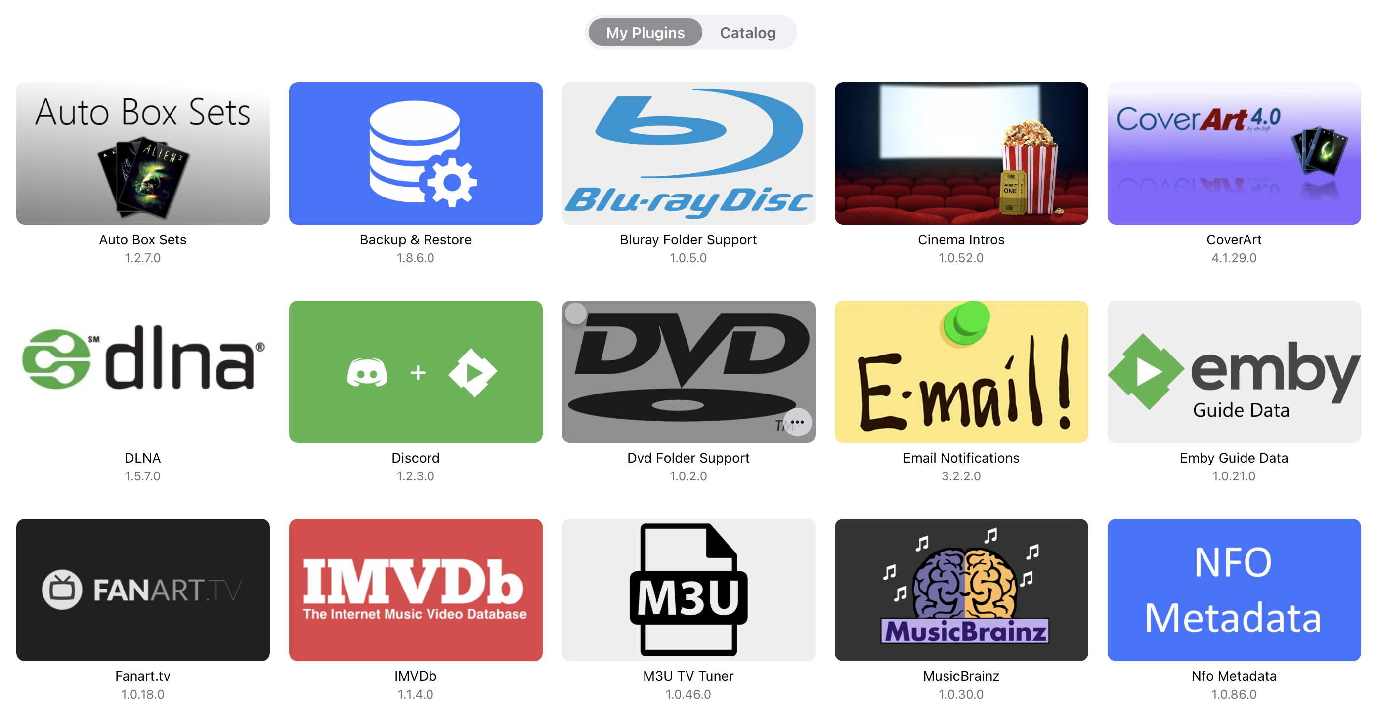

As to what happens when it stops working, the first time, I got calls from a few friends, but as I was away, I just did a remote restart. The second time I was watching it myself and just got the spinning disk, and then calls from others, and EVEN the Emby console was not responding - refresh in the browser and timeouts. I again restarted the docker container and all good again. I just checked the jellyseer logs and it is going to do a full Emby sync in 15 hours - I will be in bed then. I don't think it's that as it runs every 24 hours and this issue was at 7:10PM. To rule it out however, I just kicked off a manual full Emby sync. Checked Emby logs and processes - no impact and little log activity. With regards to external access - I have check log files for the same timeframe for jellystat, seerr, Nothing else does any sort of sync. My API keys are thus - Any idea what order, or what below may be the culprit for removal from the plugins - -

If you can get it to happen again with debug logging enabled then that may tell us more. -

The log I imagine shows my plugins. Could it be conversant or something that is incomparable with the later release? -

I have not changed anything for a long while. Except emby upgrade. By all means I can shutdown jellyseer, which if the only external thing. But it has its own request thing, it does not request emby do this. -
