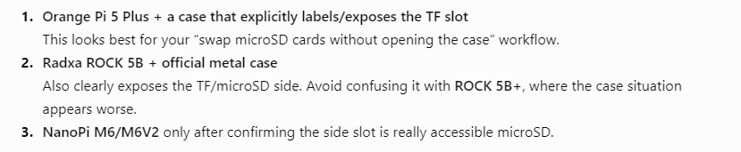

1. Orange Pi 5 Plus SoC: Rockchip RK3588. Storage Interface: Onboard M.2 M-Key slot (PCIe 3.0 x4, 2280 form factor). Multi-Boot Implementation: Equipped with a 16MB/32MB SPI NOR Flash. Supports UEFI (EDK2) deployment (need configuration) to enable a native boot menu directly from the NVMe drive. Alternatively, the MicroSD slot is positioned on the board's edge, allowing external media swapping via compatible enclosures without chassis disassembly. Enclosure Ergonomics: Compatible with standard metal cases that expose the MicroSD slot and all primary I/O ports. One-time assembly requirement is met by pre-installing the NVMe SSD and sealing the chassis. 2. Radxa Rock 5B SoC: Rockchip RK3588. Storage Interface: Bottom-mounted M.2 M-Key slot (PCIe 3.0 x4, 2280 form factor). Multi-Boot Implementation: Features a detachable eMMC module slot and an external-facing MicroSD slot. Multi-booting is achievable via customized U-Boot/GRUB configurations or UEFI images targeting the SPI Flash/SD card as the primary boot stage, while mounting core OS root filesystems from distinct NVMe partitions. Enclosure Ergonomics: Requires a dedicated aluminum heatsink-case. The NVMe drive is secured internally during the initial layout. System switching via MicroSD card swaps does not require opening the housing, as the card slot remains perimeter-accessible. I have first variant in use for almost 2 years, so I can help providing more information about this sbc. My config: Ubuntu 22.04 linux 5.10, NVMe 1TB with main OS, external HDDs for Data. - Today

Thanks for the offer, through, the FFmpeg command building we do is pretty complex and working on this requires probably more iterations than we will have beta versions over the next few years... Acquisition of a device not a problem in itself, it's rather about which one. The requirements are: The device must use: RK3588 or RK3588S The device must have an internal M.2 M-key NVMe slot. Multi-Boot The device must be able to either boot multiple OS installations from NVMe (probably doesn't work) or boot with a boot loader with a menu on regular/flash storage while the core OS is installed on NVMe or boot from a non-fixed drive while the core OS is installed on NVMe and switch OS by changing the drive's medium In this case, the "drive'" must be externally accessible without opening the case The device must be useable in all possible ways without needing to disassemble and re-assemble it more than once - ever More generally: Everything that requires more time than it should/could, is a showstopper -
