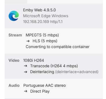

  2. As the title say. I'm currently running version4.9.5.0 inside a CT container in proxmox (previledged) - I've used Proxmox VE Scripts for the installation. It was showing the icon before. I'm not sure when it broke. I can see the Preferred Hardware Decoders in the settings, however when I'm reproducing something, in the Emby Server dashboard I don't see the hardware icon: However when I run: pgrep -a ffmpeg | grep -oE -- '-init_hw_device[^ ]*|child_device=[^ ]*|-hwaccel[^ ]* [^ ]*|vpp_qsv[^ ]*|-c:v:[0-9]+ [^ ]+' I can see: -init_hw_device child_device=/dev/dri/renderD128 -c:v:0 h264_qsv -hwaccel:v:0 qsv -hwaccel_output_format:v:0 qsv vpp_qsv@f1=deinterlace=advanced[f1_out0] -c:v:0 h264_qsv Additionally, if I disable the hardware encoding I see the CPU utilization going up when reproducing. So I'm sure that I'm using hardware. Is this a bug? Thanks!
