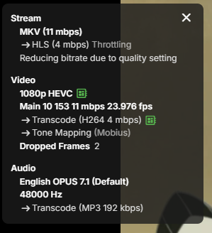

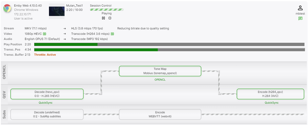

You might have to provide more details because in my case the new stable release did resolve the HW tone mapping.
