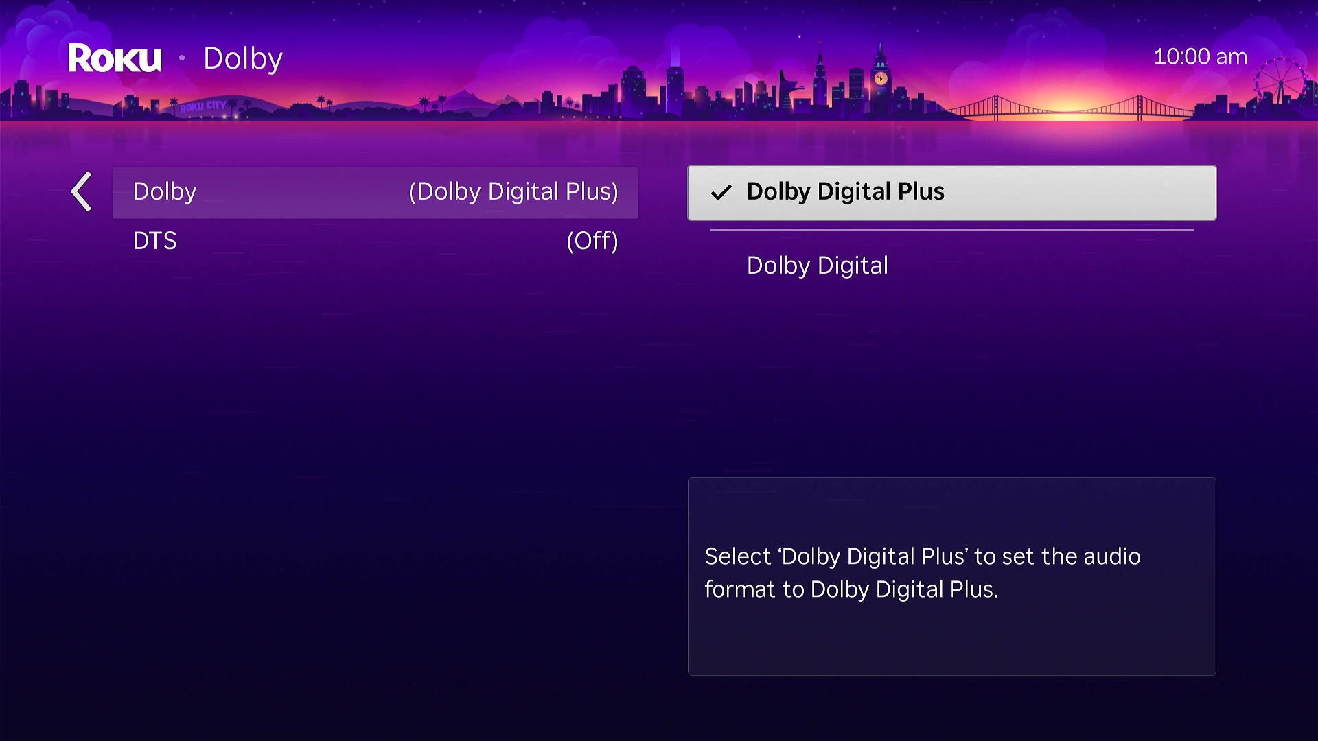

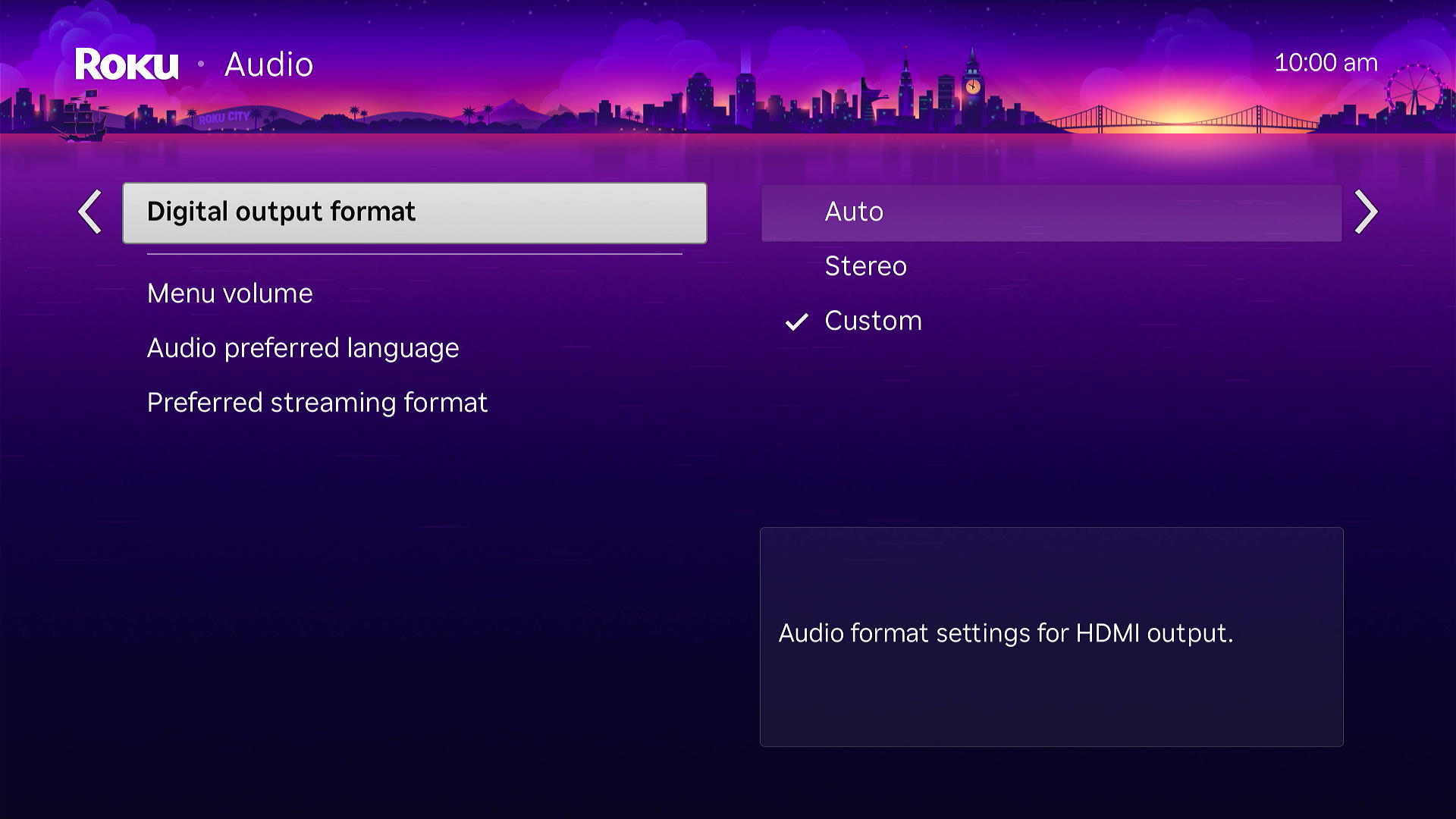

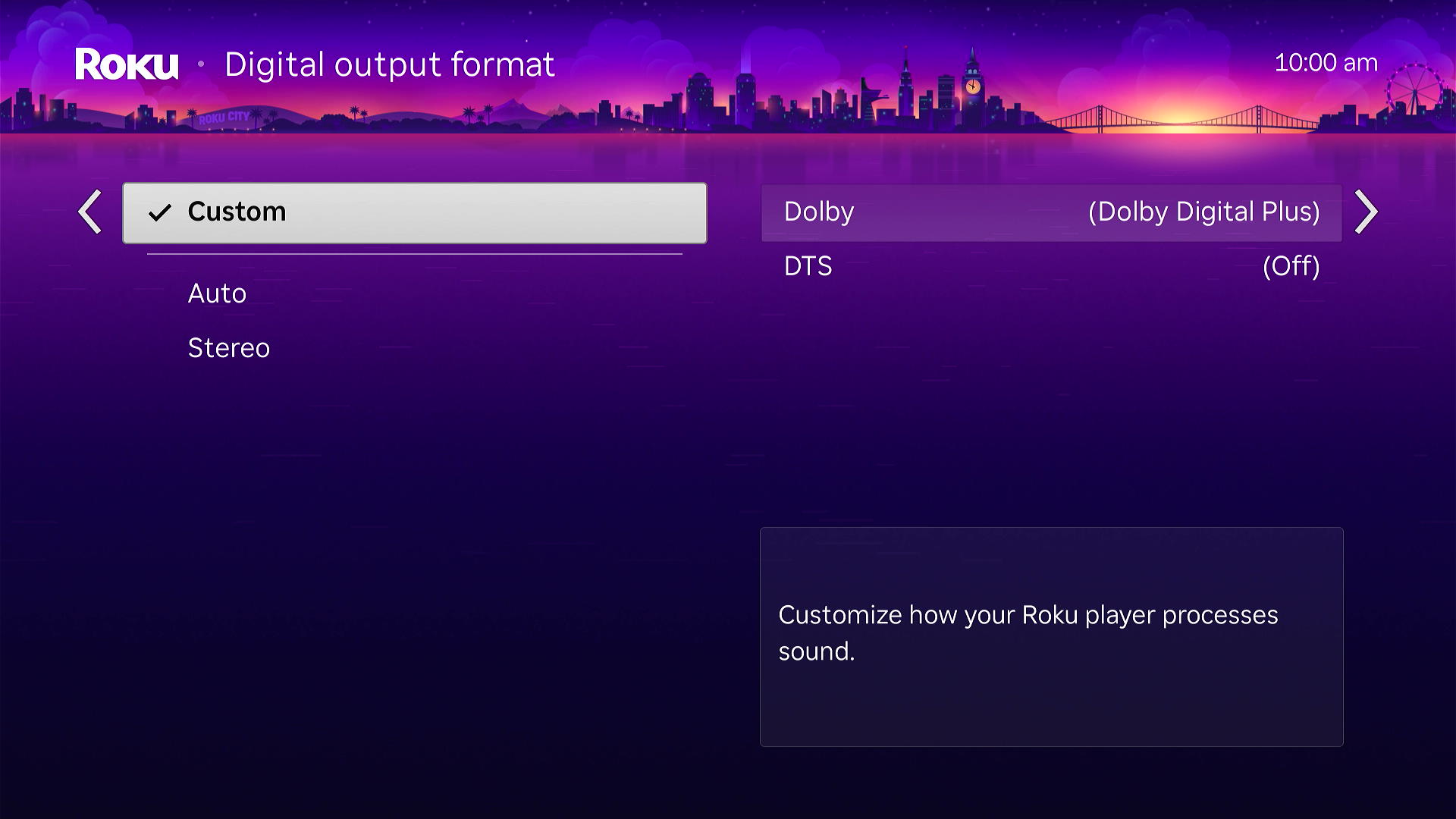

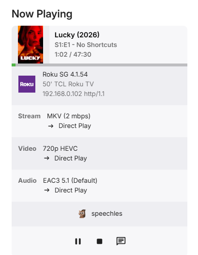

@Mosetter27 What do you have set for your Roku audio settings? Specifically, the Digital Output Format? Also, what model of Roku are you using? You can try to set yours identical to how I have set mine above. Then play that same item. The item should now play correctly, but do you hear audio? @ebr Here is how MediaInfo indentifies the audio stream from that file. I have the same problem with this series. On the Roku TV this works perfectly. But I do not know if it works on all.

This is for me and @ebrto fix (and perhaps @Luketoo). I've only asked that question of you to make sure you aren't creating the issue yourself like I did. I had to disable audio transcoding to get the same failure you had. Since you did not have to do this it is something on our end we must fix. You do not need to change anything. We need to investigate why and how this happens and fix it. Thank you for reporting the bug. We will try to get to the bottom of this. When we do we will follow up in this thread to keep you in the loop too. But for the moment it appears a breaking change somewhere has caused this and we need to identify where.
negative. I'm mildly good at computer things and tend to only change things when told. most stuff is defaults. is there something I should check on my computer end to see? also of note I only have one user and just log in that way onto my devices. never dove into setting up different users for fear of something getting messed up. im of the age old if it aint broke don't fix it type.
