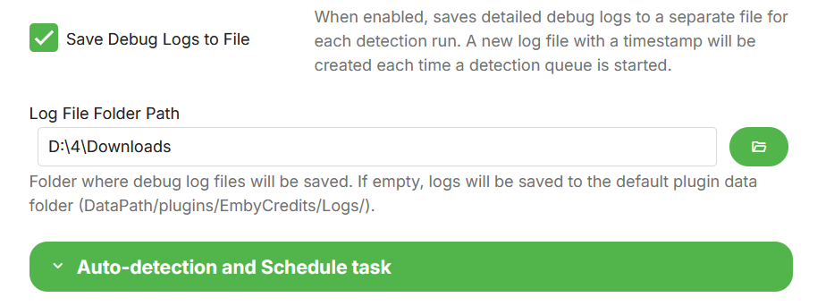

Doesn't look to be stalled, there's just a lot of noise in the log from another plugin (TMDB api lookups). FFmpeg did cause an error at one point, i'm working on adding a guard againts that but other than that i don't really see a problem in the log. When that version is done can i get you to make the plugin save individual logs? That will remove all the noise. -

fbourg replied to yocker's topic in Plugins
Hi @yocker, To answer your question: it definitely stalled mid-detection rather than finishing early or skipping files. Out of roughly 62,000 episodes in my library, only around 3,000 have been processed so far. The remaining ~59,000 are untouched and do not have any credit markers or previous timestamps. Looking closely at the log, the batch processing kicked off for Les Griffin Season 5 at 00:15:20.395, and then the plugin stopped logging completely while server-side TMDB queries were running. The scheduled task just hung right there. I'm ready to test your upcoming build as soon as it's available. Thanks for looking into it! -
yocker replied to yocker's topic in Plugins
@fbourgDoes the plugin act like it was done or has it stalled mid detections? Looks like a lot of episodes was added to the queue that already had time stamps or failed and the plugin skipped them. If you look purely on the ETA then the time left can be very deceptive and can fluctuate A LOT. You add items to queue. It start detections on episodes and the ETA goes up to lets say 2 hours. Then 80% of the files suddenly doesn't have to have detections run anyway and the ETA can seem to be wrong because most of the work suddenly disappeared. That said, looking in the logs i might have found a problem. I will have a version ready for you to try soon. - Today
its new version 2.9.0.1 ? -
Hi. I have 3 firesticks exhibiting the same problem. The one I'm testing now is fire TV stick hd (1st gen) running fire os 7.7.1.6 The emby version on the firestick is 2.1.54a It's not just this particular episode that is causing issues. Alot of the x265 encoded episodes are having this problem recently
The plugin stopped again overnight. Here are the files. Version 2.9 embyserver-63925725666.txt embyserver.txt -
