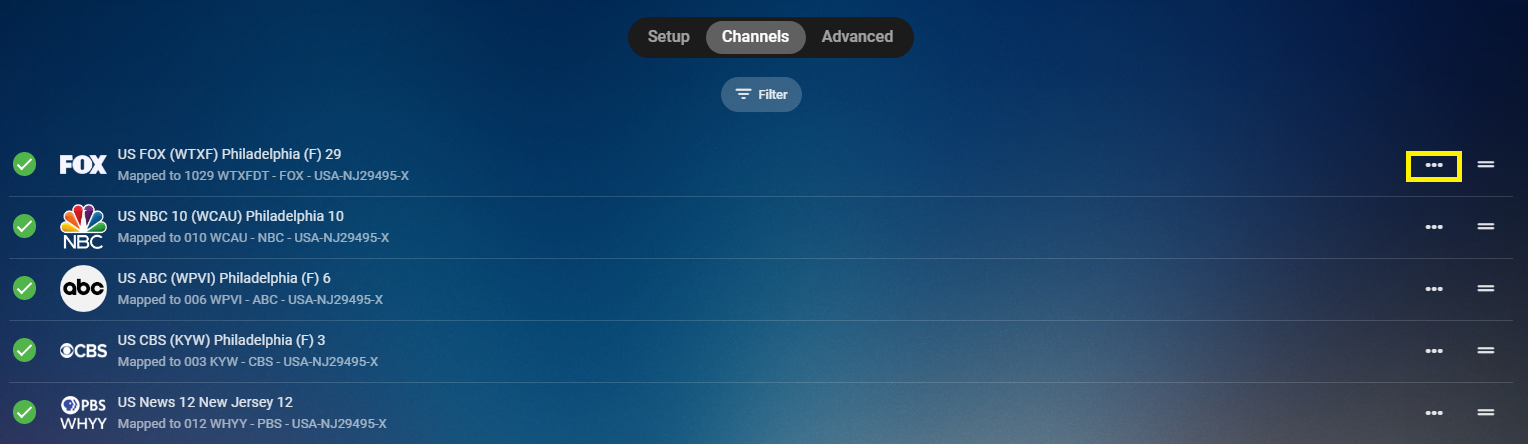

    From the Live TV menu, click the Channel tab at the top of the screen. Click the 3 dot menu to the right on any channel you wish to edit.
    Channelmapping 1
    Click the Edit button on the popup screen.

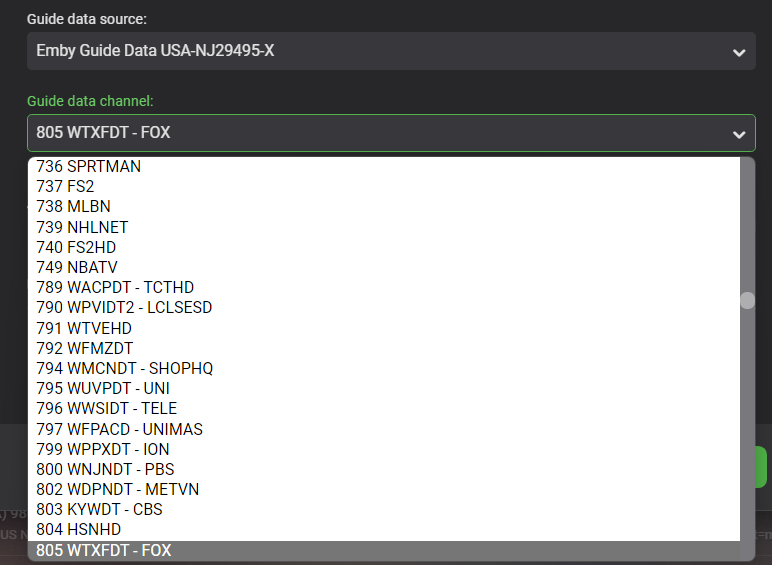

    You can now select the Guide Provider to use as well as the station from that Guide.
    Channelmapping 3
    Click the Save Button when done editing this channel.
