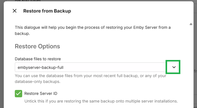

    On the Current Backup Info screen, Click on Restore from Backup.
    This will show the following screen:
    In Restore Options section, open the drop-down to see the list of all available database backup sets.
    Select the backup for the day/time you wish to go back to.
    As this restore is not for a new additional server, keep the "Restore Server ID" ticked.
    Note
    Whilst the databases will be restored for the selected date/time, the other emby server data will be restored from the last backup.
