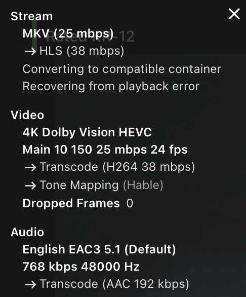

hoonlight 17 Posted September 26, 2024 Posted September 26, 2024 Is there an update on this? All the hevc .mkv videos I have are transcoded when playing in safari. In chrome and emby app, they play directly. Another thing, I found that if I convert the .mkv files to .mp4 (and convert the audio stream to aac), they don't get transcoded.
Luke 40006 Posted September 26, 2024 Posted September 26, 2024 3 hours ago, hoonlight said: Is there an update on this? All the hevc .mkv videos I have are transcoded when playing in safari. In chrome and emby app, they play directly. Another thing, I found that if I convert the .mkv files to .mp4 (and convert the audio stream to aac), they don't get transcoded. Hi there @hoonlightdid you explore the stats feature in the video player to learn why it was transcoding?
hoonlight 17 Posted September 26, 2024 Posted September 26, 2024 (edited) 1 hour ago, Luke said: Hi there @hoonlightdid you explore the stats feature in the video player to learn why it was transcoding? Hi, I've attached the log, thanks. I tested on M1 pro macbook, M1 ipad pro, iPhone and all the same. In Chrome on macbook, only audio is transcoded, video is direct play. And in emby app both video and audio are direct play. I thought this was a Safari issue from when I first started using emby until now, I wish there was a way to direct play. I just checked, and videos that are 4k hevc .mkv files but are SDR can be direct play. does safari not support hdr10, DV direct play? ffmpeg-transcode-1904778c-5f73-4c91-a0b0-5f188d1d1637_1.txt Edited September 26, 2024 by hoonlight
hoonlight 17 Posted September 26, 2024 Posted September 26, 2024 (edited) If you need more logs, let me know. Edited September 26, 2024 by hoonlight
Luke 40006 Posted October 24, 2024 Posted October 24, 2024 On 9/26/2024 at 10:43 AM, hoonlight said: If you need more logs, let me know. Hi, can you try resetting your customizations back to defaults: >>>>> Non-Default Encoder Parameters Warning EncoderParametersH264Qsv.Preset: Original: Actual: medium Warning EncoderParametersH264Qsv.BitrateMode: Original: Classic Actual: Vbr Then see how things compare. Thanks.
hoonlight 17 Posted October 29, 2024 Posted October 29, 2024 (edited) On 10/25/2024 at 2:11 AM, Luke said: Hi, can you try resetting your customizations back to defaults: >>>>> Non-Default Encoder Parameters Warning EncoderParametersH264Qsv.Preset: Original: Actual: medium Warning EncoderParametersH264Qsv.BitrateMode: Original: Classic Actual: Vbr Then see how things compare. Thanks. Yes, I changed the relevant settings to default and then attached a log of the playback. The first and second videos are transcoded when played in safari, only the third video, which is not HDR, does not have the video stream transcoded. ffmpeg-transcode-7e2b3a07-7ea4-45a2-95e2-6616c845a859_1.txt ffmpeg-transcode-3b583978-4dcb-43e7-9000-dff753970f09_1.txt ffmpeg-remux-b260c375-0dac-49ba-9d98-41102403295d_1.txt embyserver-6.txt Edited October 29, 2024 by hoonlight
