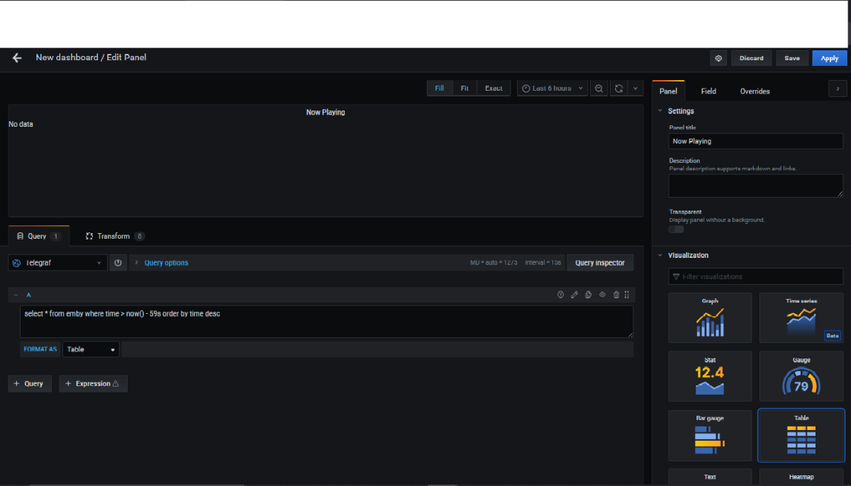

plittlefield 46 Posted February 11, 2021 Author Posted February 11, 2021 Yeah, the trick was choosing a table and then hiding certain fields from the database. Here are 3 screensnots from mine...
tinni88 0 Posted February 11, 2021 Posted February 11, 2021 thanks for the screenshots that will give me something to go on but for some reason I'm still getting no data showing. the problem is clearly right in front of me and I'm being thick lol with your second screenshot i dont seem to have the data paging options type in any of my options unless im missing something
plittlefield 46 Posted February 11, 2021 Author Posted February 11, 2021 That's right, you need to click the pencil icon to enter text edit mode and type in the following:- select * from yourmeasurementnametable where time > now() - 59s order by time desc My measurement is called 'emby' which you can see from the posts above in this forum thread, but yours may be called something else.
tinni88 0 Posted February 11, 2021 Posted February 11, 2021 Yeah I've tried that but still nothing still coming up as no data I'm starting to think that i may have messed up the script some how and it not grabbing the data from the command but the command works in terminal and receives the correct response and the script is connecting to influxdb and creating the csv and the data name is shown under measurements in grafana (emby) but showing no data on the table so maybe its not passing the csv file over or something I'm completely out of ideas I'm very grateful for your help on this your script I'm using "#!/bin/bash # load variables CSVFILE=/mnt/user/embysessions/emby.csv; # get list of now playing items and send to jq output as csv wget -q -O - "http://Loaclhost:8096/emby/Sessions?api_key=62ab***************************" | jq -r -M '.[] | {UserName, SeriesName: .NowPlayingItem.SeriesName, Name: .NowPlayingItem.Name} | select(.Name != null) | {user: .UserName, item: ((if .SeriesName then .SeriesName + " / " else "" end) + .Name)} | map(.) | @csv' # show csv file to check output echo cat $CSVFILE; echo # read csv file to parse values and send to influx via http post while IFS=, read -r user item; do curl -i -XPOST 'http://Localhost:8086/write?db=telegraf' --data-binary "emby user=$user,item=$item" done < $CSVFILE; # finish exit;" log output "Script Starting Feb 11, 2021 13:49.47Full logs for this script are available at /tmp/user.scripts/tmpScripts/emby-influxdb/log.txt"Kids","Blippi / Monster Truck Song - Educational videos for preschoolers - Blippi""Jade","NCIS / Kill the Messenger""Jade","NCIS / Kill the Messenger""Kids","Blippi / Monster Truck Song - Educational videos for preschoolers - Blippi"% Total % Received % Xferd Average Speed Time Time Time CurrentDload Upload Total Spent Left Speed100 49 0 0 100 49 0 16333 --:--:-- --:--:-- --:--:-- 24500% Total % Received % Xferd Average Speed Time Time Time CurrentDload Upload Total Spent Left Speed100 98 0 0 100 98 0 32666 --:--:-- --:--:-- --:--:-- 32666Script Finished Feb 11, 2021 13:49.47Full logs for this script are available at /tmp/user.scripts/tmpScripts/emby-influxdb/log.txt"
tinni88 0 Posted February 11, 2021 Posted February 11, 2021 forgot to say I'm running unraid and emby is running as a docker
tinni88 0 Posted February 11, 2021 Posted February 11, 2021 So after hours of driving myself up the wall i have finally figured it out i missed part of the script off. (numpty lol) I now have it up and running in grafana and populating how it should and i do thank you Paully for all your help and also for posting this been a massive help #!/bin/bash # load variables CSVFILE=/mnt/user/embysessions/emby.csv; # get list of now playing items and send to jq output as csv wget -q -O - "http://Loaclhost:8096/emby/Sessions?api_key=62ab***************************" | jq -r -M '.[] | {UserName, SeriesName: .NowPlayingItem.SeriesName, Name: .NowPlayingItem.Name} | select(.Name != null) | {user: .UserName, item: ((if .SeriesName then .SeriesName + " / " else "" end) + .Name)} | map(.) | @csv' >$CSVFILE; <--- Was Missing this # show csv file to check output echo cat $CSVFILE; echo # read csv file to parse values and send to influx via http post while IFS=, read -r user item; do curl -i -XPOST 'http://Localhost:8086/write?db=telegraf' --data-binary "emby user=$user,item=$item" done < $CSVFILE; # finish exit;
