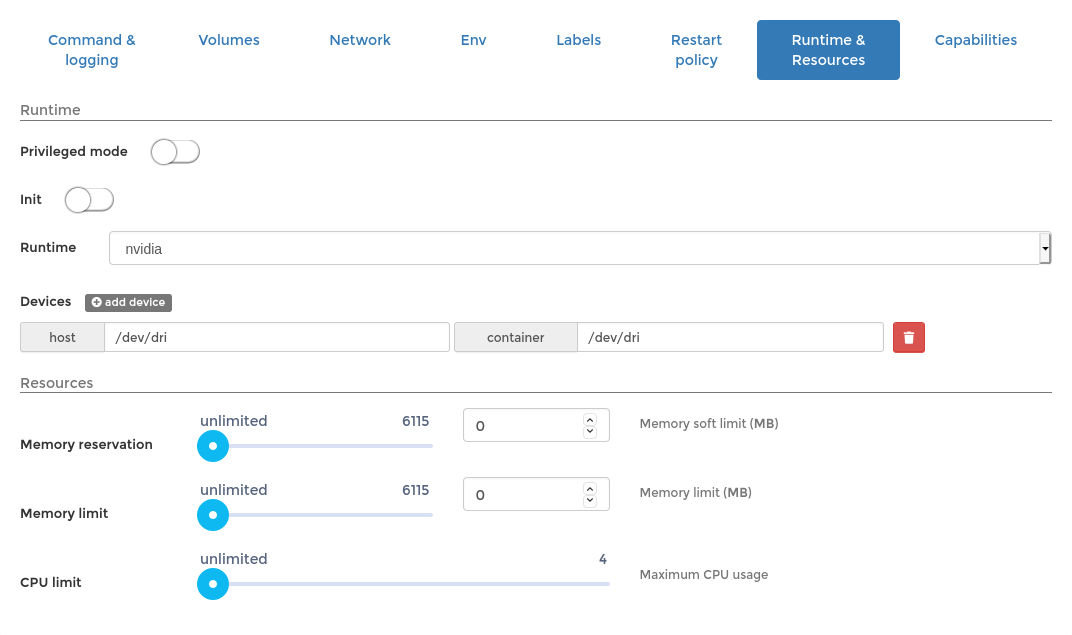

@Luke I tried and it's exactly the same result. Here are my docker environment variables and runtime. I posted another image from my desktop where it works, it looks exactly the same. I think the problem that is happening is the command is returning intel ID instead of nvidia, I am doing this from the official instruction, so I dont know what else to do.
getent group render | cut -d: -f3

ChoromPotro
10 hours ago, Luke said:
What are the differences in setup between the two?
I shared the screenshot in the previous post :D
