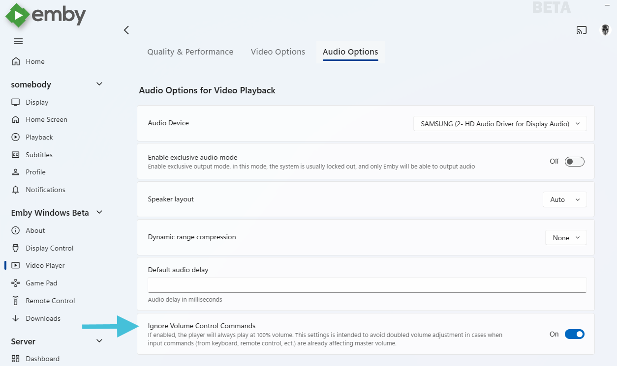

Solution softworkz 5063 Posted December 28, 2024 Solution Posted December 28, 2024 The next update has an option that allows to ignore volume changing input commands: 1
