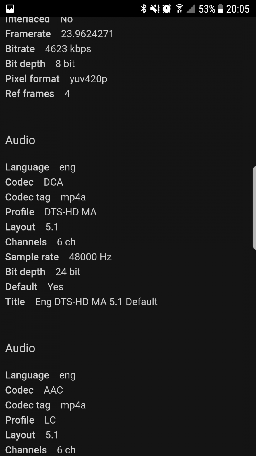

Dex150489 2 Posted September 13, 2017 Author Posted September 13, 2017 Evening guys, so here we are again. Having the same sync issue. I've played the same mp4 on the xbox one (latest) and pc (version 2.8.3) apps and there are varying degrees of audio sync problems. The android app on my phone and the web browser play perfectly from what i can see. I've attached screen shots of all the details of the particular episode in question. Is there any other deails i can give you? Thanks
Guest asrequested Posted September 14, 2017 Posted September 14, 2017 Evening guys, so here we are again. Having the same sync issue. I've played the same mp4 on the xbox one (latest) and pc (version 2.8.3) apps and there are varying degrees of audio sync problems. The android app on my phone and the web browser play perfectly from what i can see. I've attached screen shots of all the details of the particular episode in question. Is there any other deails i can give you? Thanks When you play on Xbox, does it direct play? And mpv as just been updated in Theater. Try that and see if there's any improvement.
Dex150489 2 Posted September 15, 2017 Author Posted September 15, 2017 On xbox it is playing direct (see attachment). At the moment its playing ok on the xbox. Since the last few updates have heavyily changed the settings menu is there a guide of some kind to explain some of the advanced settings? Also the madvr video player settings..what is the minimum specs for running this before its pointless switching it on?
Guest asrequested Posted September 15, 2017 Posted September 15, 2017 In your picture, the audio is being transcoded, so that may have been the issue. In Theater I don't use MadVR. Unless you're very particular about picture quality, I'd suggest sticking with mpv. Do you have a sync issue with mpv?
