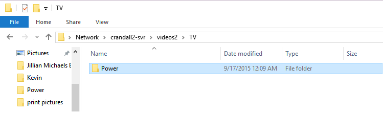

kcrandall758 1 Posted September 22, 2015 Posted September 22, 2015 (edited) here's screenshots of my folder setup: also, reason I set up my structure the way I did is because of https://github.com/MediaBrowser/Wiki/wiki/TV%20naming: "For a simple TV folder structure, the recommended folder layout is Series\Season\Episode or Series\Episode." I opted for the second method. Edited September 22, 2015 by kcrandall758
Luke 39631 Posted September 22, 2015 Posted September 22, 2015 Ok - you don't want to add the Power series itself as your library, but instead add the folder above it, the \TV folder. 1
kcrandall758 1 Posted September 22, 2015 Posted September 22, 2015 so, I removed the old folder structure as recommended and just added the TV folder; now, I can see the Power folder under the Metadata Manager, but I still see nothing in Emby itself.
