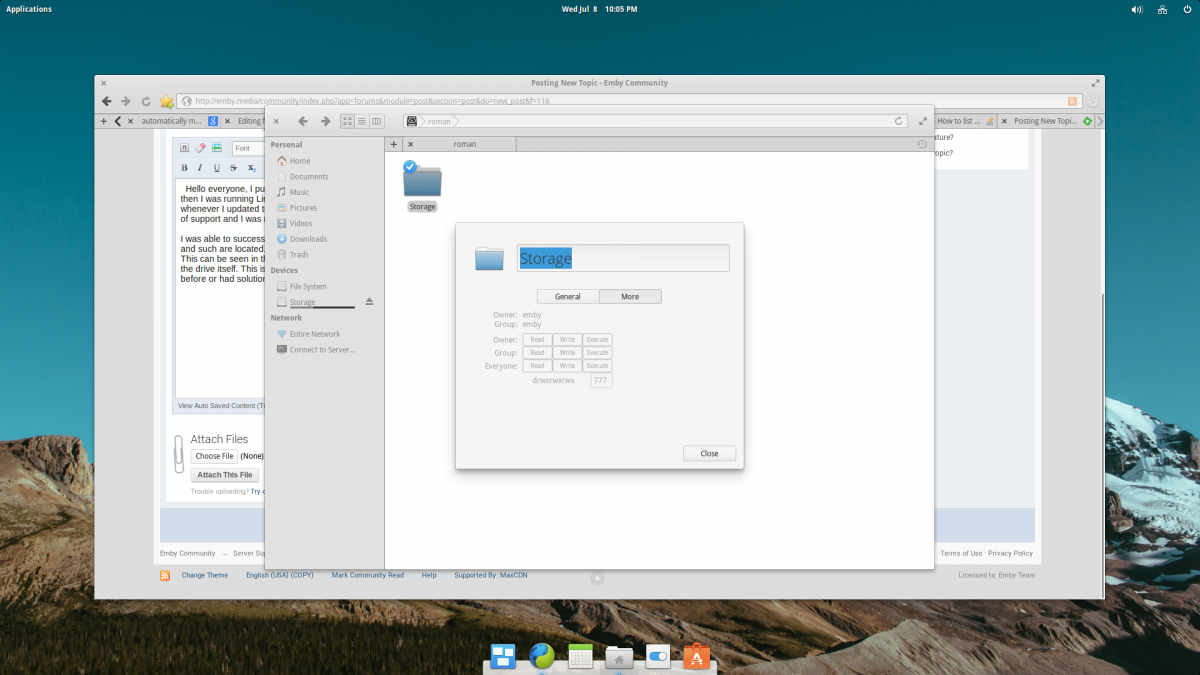

raddyroro 0 Posted July 9, 2015 Share Posted July 9, 2015 Hello everyone, I put all my DVD's, CD's and home movies onto a server about a year ago so that We could clean up the house and store everything in one place. Back then I was running Linux Mint Petra with Plex as my media server choice, it was the only one I knew about. I kept coming up with problems with read/write permissions whenever I updated to Ubuntu or a newer version of Linux Mint, so I just decided not to touch it, and it worked for the most part for a long time. After a while, Petra fell out of support and I was no longer able to update my system. I recently decided to install elementary OS (based on Ubuntu 14.04) and make the switch to Emby. I was able to successfully install Emby but I am still encountering problems with permissions, the same problems I had with Plex. When adding folders where my Movies and such are located, Emby can only go as far as the drive, but it cannot see anything in the drive itself. (Picture:) I run my OS on a separate hard drive from where I store my media. This can be seen in the screen-shots attached. Currently my storage drive is assigned to emby as the primary user, with all permissions, yet it cannot find anything inside the drive itself. (Picture:) This is the exact same problem I was encountering with Plex and I was unable to fix it no matter what I did. I was wondering if you had problems like this before or had solutions that I never thought of. Please let me know if you have any questions, since I have not provided all the information. It is really aggravating since I have tried everything, installed multiple versions of three different distros, and tried both Plex and Emby, none of it working. Link to comment Share on other sites More sharing options...
geaves 13 Posted July 9, 2015 Share Posted July 9, 2015 As a quick reference Emby needs to 'see' the second hard drive...i.e. it needs to be mounted, to mount the drive using a file browser such as nemo or nautilus is not enough as Emby will not 'see' it. There is an excellent 3 part video on you tube 'installing a second hard drive on linux part 1' by Chris Walker which explains this (if I post the link it embeds the video), whilst this is being used on a virtual machine the concept and setup within the 3 parts will resolve what you are trying to achieve. These videos show how to do this using putty, remoting in from another machine, but you would do this from a terminal window. Hope this helps. Link to comment Share on other sites More sharing options...
raddyroro 0 Posted July 9, 2015 Author Share Posted July 9, 2015 (edited) Thanks for the help so far, I have manged to mount the hard drive automatically via fstab (see picture below), but emby still fails to 'see' the hard drive. It is currently assigned to my group, which the emby user is in, so it should have RWX permissions. It can see that there is a hard drive there, but it still fails to find any of the folders inside. Edited July 9, 2015 by raddyroro Link to comment Share on other sites More sharing options...
Solution geaves 13 Posted July 10, 2015 Solution Share Posted July 10, 2015 You'll need to create a an fstab entry for each of your media folders so...../dev/sbd1 /media/roman/Storage/<Media Folder Name> and so on it should then work. 1 Link to comment Share on other sites More sharing options...
