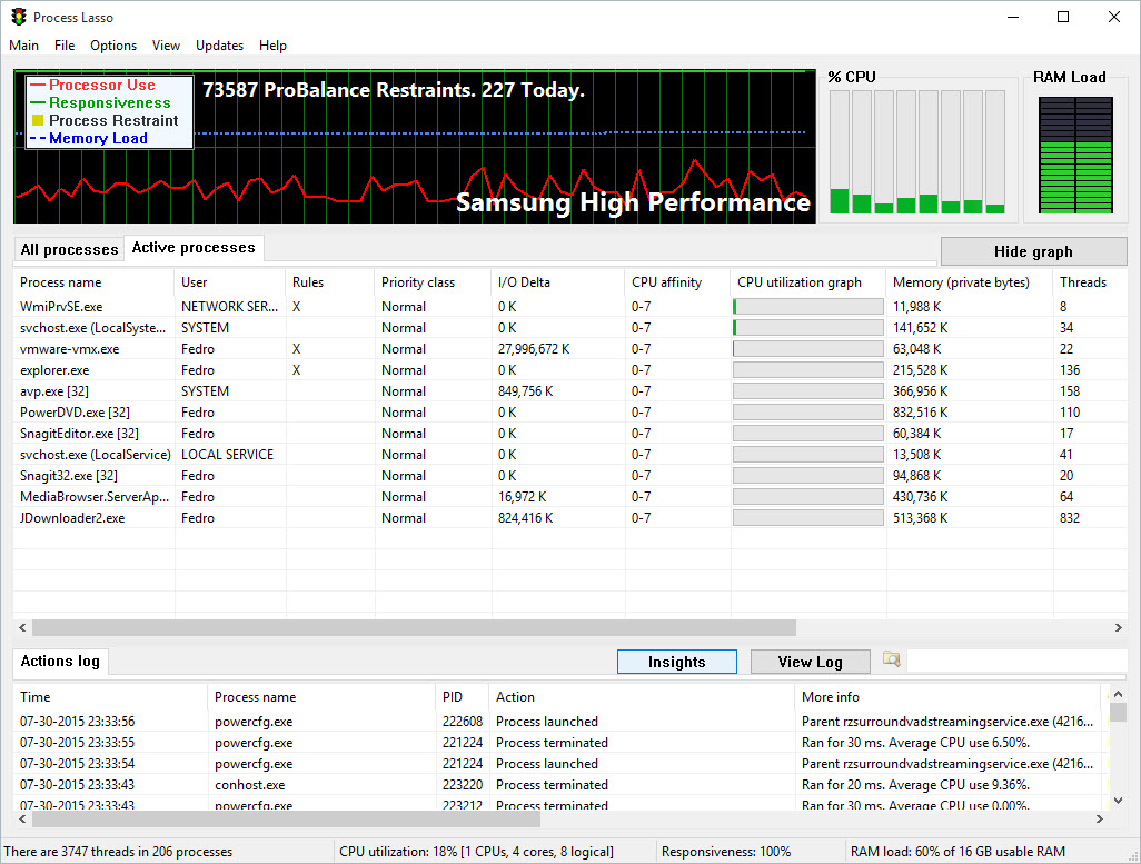

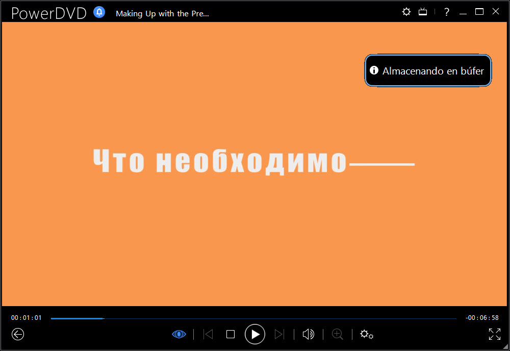

I am facing similar issues not just with Chrome but with Opera and Firefox. A few updates before I had no problems at all. Performance should not be an issue (Core i7 4 Cores, 16 MB RAM).. as I said I was experiencing no issues before. Something else I noticed is that ffmpeg runs (albeit consuming quite a few system resources) but it generally goes way ahead of the currently displayed video (one may notice the green back is behind the orange one in the dashboard), so my conclusion is that this is not a transcoding issue but actually how the temporary ts file is streamed to the client. I am aslo able to play the temporary  transcoded ts file in VLC without issues.
This is specially noticeable while trying to DLNA play to PowerDVD 15 as the video will contiously show "buffering" while playing any type of file but transcoding may be very well completed. (I tested this out with a 5 minute video where PowerDVD would show buffering but transcoding bar (the orange one is very well at 100% and the temporary ts file playable to the end in VLC)
A couple of snapshots...
This one shows the DNLA PowerDVD client. As you may notice transcoding is already completed (lower blue bar).
While PowerDVD shows a ´buffering´ message:
Again, this does not seem to be related to a performance issue.... CPU is not overloaded...
and transcoded temporary file is alive and well (and fully transcoded)...
