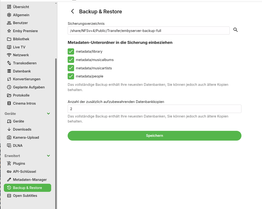

As for not seeing previous backup, did you configure the plugin to the same folder as previous backup?
May need a screen shot of the Backup and Restore settings.
kellerduell
Yes, the plugin is configured for the same folder.
I'll attached the screenshot of Backup and Restore and the log-file.

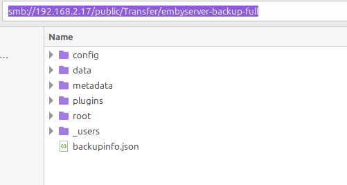

Sorry but you don't point to the full backup folder as that is the backup, you point to your Transfer folder that contains the actual backup.
May need to see the content of the folder but correcting the level should show the backup assuming the backupinfo.json file is in /embyserver-backup-full.

I created the storage path there so that the backup would be stored there. How can I restore the backup?
  • Solution
Happy2Play
Point the backup path to the /Transfer folder in the plugin setup assuming all permissions are correct, the backup should show up.
kellerduell
Thank you for your help. That worked for me! 👍
