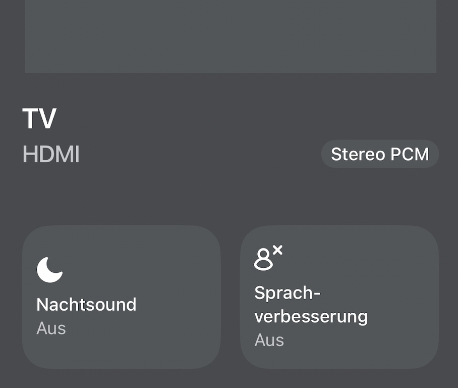

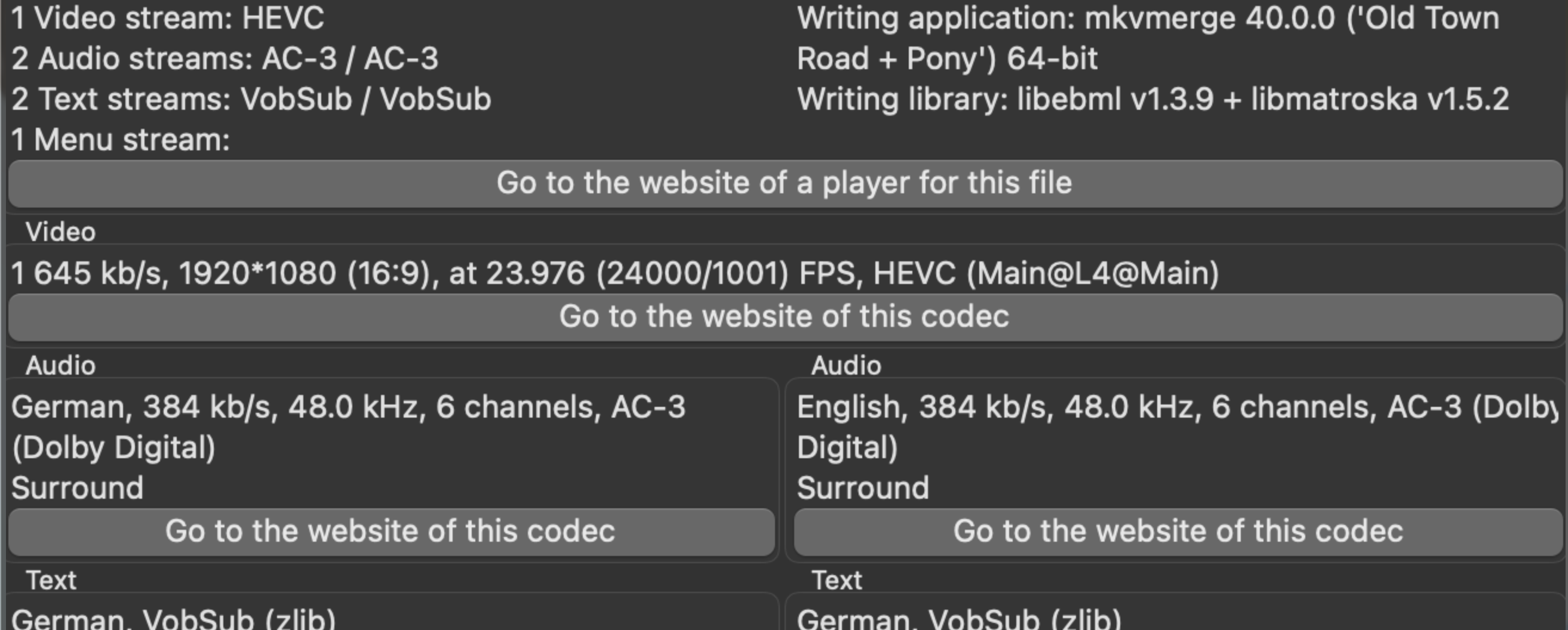

Imhotep 0 Posted October 20 Posted October 20 Hi all, I’ve run into a consistent audio passthrough issue between two LG OLED TVs using the same Emby Server setup, and it seems to be related to the new audio handling in webOS 23. Setup Emby Server: 4.8.11.0 (running on NAS) Clients tested: LG OLED65G39LA (G3, webOS 23) LG OLED65C17LB (G1, webOS 6) Sound system: Sonos Arc Ultra (connected via HDMI eARC) Emby App: current LG webOS version from Content Store Network & content: same Emby Server, same user, same AC3 5.1 media file Problem When playing an AC3 5.1 file through Emby on the G3, the Sonos reports PCM 2.0. The same file, via Emby on the G1, plays correctly as Dolby Digital 5.1. Both TVs are configured identically: HDMI eARC: On Digital Audio Output: Passthrough No other apps (e.g. Netflix, Disney+) show this issue — they correctly pass Dolby Digital Plus / Atmos to Sonos on both TVs. Testing / Observations The media file contains a valid AC3 5.1 track (verified in MediaInfo). In the Emby Dashboard → Activity, playback on the G3 shows Direct Play (Audio: AC3), yet the TV outputs PCM 2.0 over eARC. The same file on the G1 outputs Dolby Digital 5.1 as expected. If the server is forced to transcode to AC3, Sonos correctly shows DD 5.1 again. Likely Cause Starting with webOS 23, LG replaced the legacy AVPlay playback API with the new MediaKit framework. This framework no longer allows direct AC3 bitstream passthrough unless the app explicitly uses the new Bitstream API. Because the Emby webOS client currently targets the older playback method, AC3 audio is decoded to PCM internallyby the TV before being sent to eARC — hence the “PCM 2.0” output. The older G1 (webOS 6) still uses the old AVPlay engine, which supports direct AC3 bitstream passthrough — that’s why it outputs proper Dolby Digital 5.1. Suggested Fix / Workaround Add support in the webOS client for MediaKit’s Bitstream passthrough API on webOS 23+. Or provide a setting to force AC3 transcoding server-side for LG clients running webOS 23 until passthrough is reimplemented. Summary TV Model webOS Emby Client Behavior Output LG G1 (C1, 2021) webOS 6 Uses legacy AVPlay passthrough Dolby Digital 5.1 LG G3 (2023) webOS 23 MediaKit decodes AC3 to PCM PCM 2.0 Would be great if the Emby team could confirm whether Bitstream passthrough for webOS 23 is already planned or if there’s a workaround for the new LG audio pipeline. Thanks a lot for your time
Luke 41280 Posted October 20 Posted October 20 Hi there, let's look at an example. Please attach the information requested in how to report a media playback issue. Thanks!

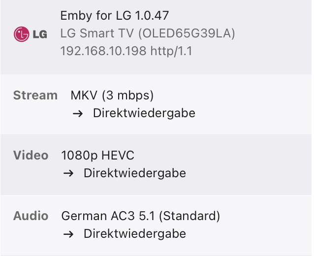

Imhotep 0 Posted October 20 Author Posted October 20 Are the files attached, or is anything else needed? ffmpeg-transcode-de16642f-9688-4e6c-8459-d2123ecbabaa_1.txt

SamES 1041 Posted October 23 Posted October 23 Assuming that on both LG TV's it is DirectPlaying (check Stats for Nerds) then it sounds like a TV/Firmware issue and probably hard for us to work around. You say there is new audio handling for LG, but I'm not sure what you are referring to

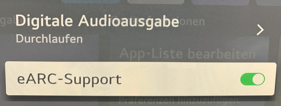

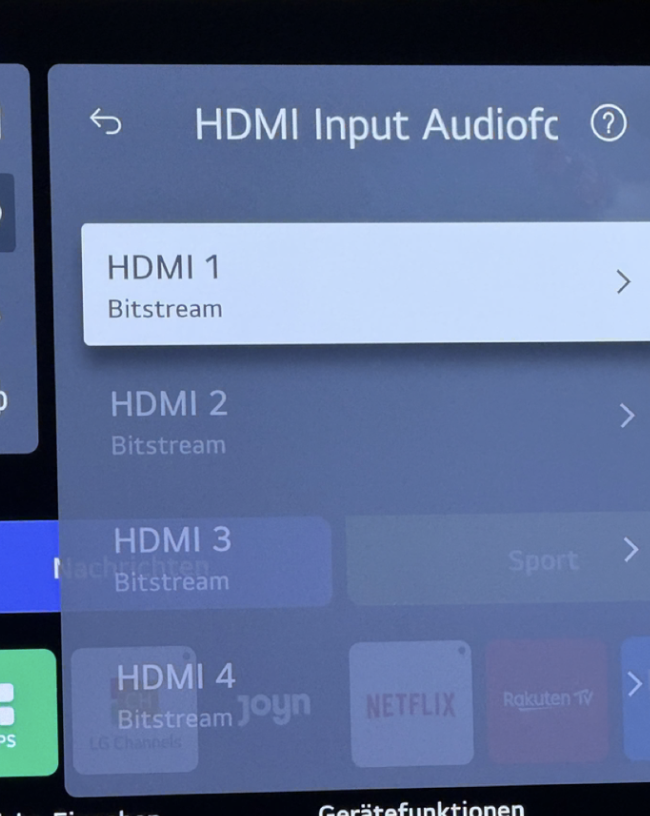

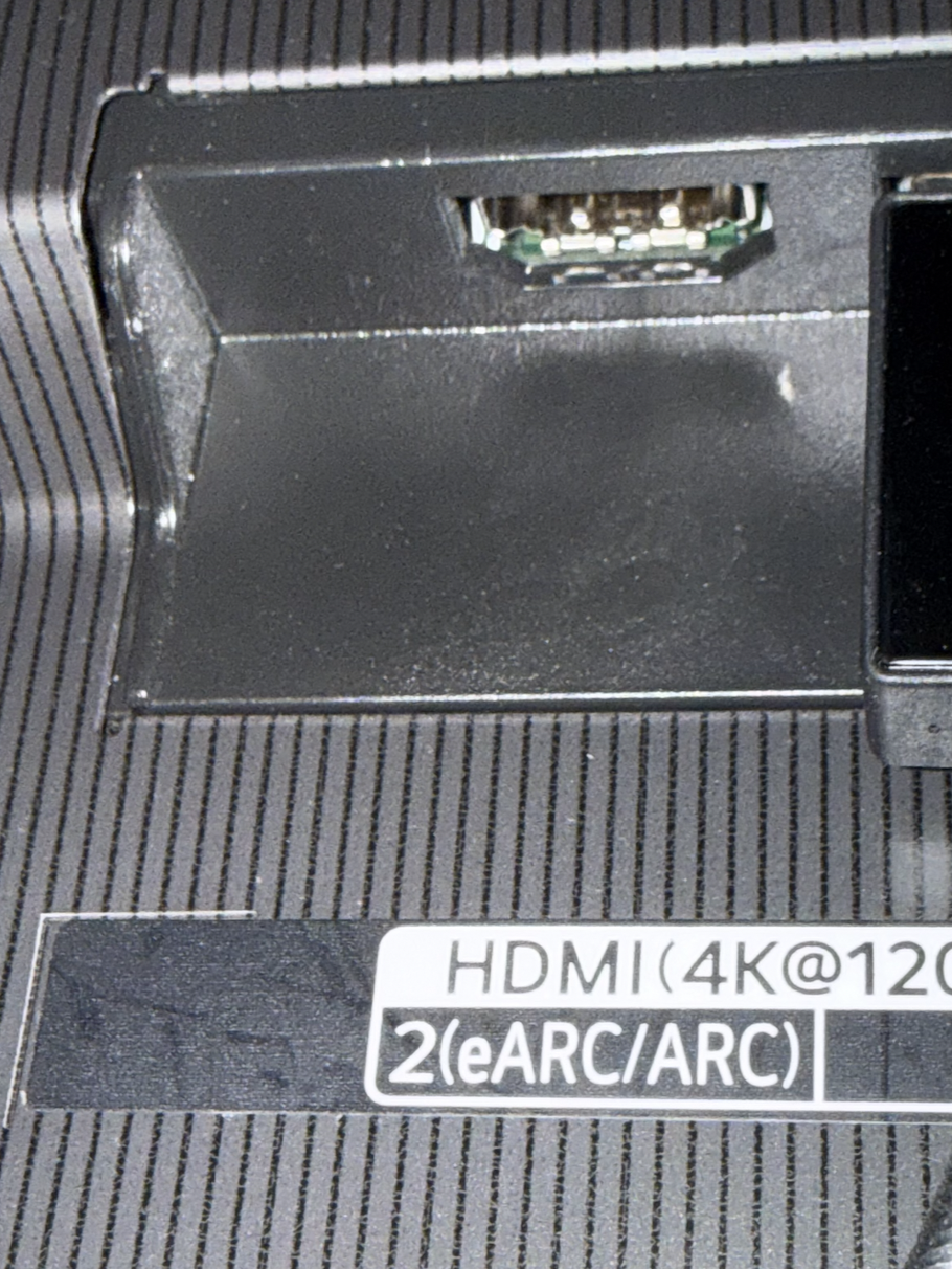

Imhotep 0 Posted October 30 Author Posted October 30 (edited) If you are connecting your TV's HDMI 2 (arc/earc) port to your soundbar, for example, then you need to configure the settings as follows: All settings > Sound > Advanced settings > Digital output > Pass-through The images are from a German WebOS, so it may be called something different in your language. Now the signal is transmitted directly from the source to the soundbar, where it is also decoded. If your input signal comes from HDMI 1, for example, you need to set it to bitstream in the settings, then it will work without any problems. When connected and set up in this way, the TV passes the incoming audio signal through to the receiver without processing it. If the receiver cannot handle the signal, e.g. DTS:X Pro, the signal is usually output via PCM Multichannel. Edited October 30 by Imhotep
