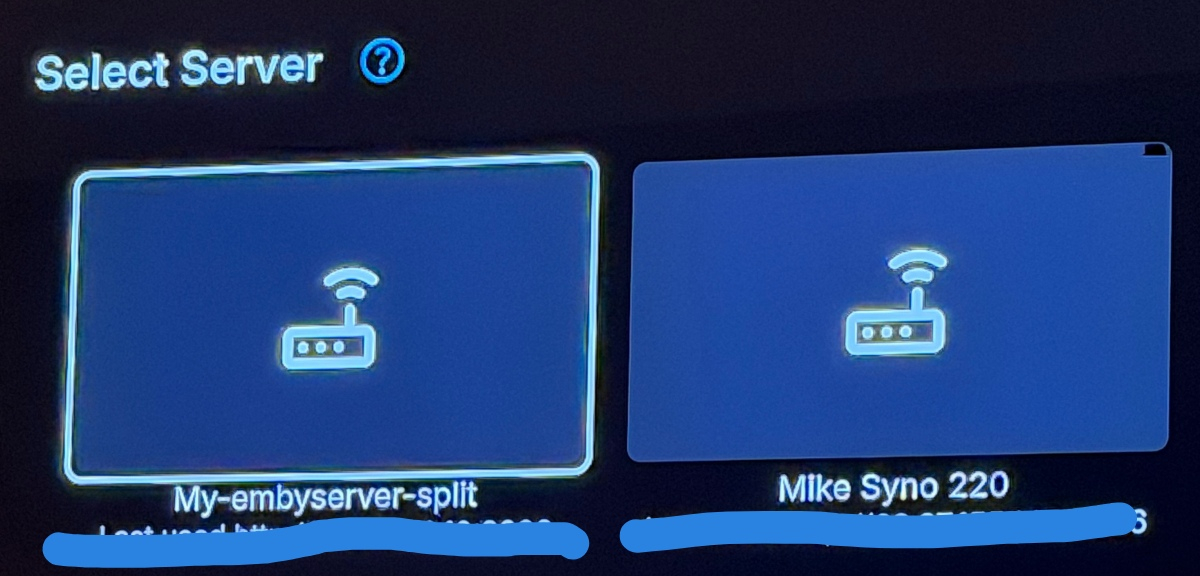

Trapperjohn61 24 Posted October 15 Posted October 15 (edited) Hi, So I installed Emby for android 3.5.12 on my friends firestick so he can access his sever. At this time I do not wish for him to access my server. Yet when going to the side menu he selects the 2nd choice which shows his server name he see my server too. How do I prevent him from seeing my server in the list so it only shows his? I also want to be able to see his server from my Emby app at home. So he does not see mine but I see his and can access it through app I have attached a pic of the servers seen Thank you for your help, Bryan Edited October 15 by GrimReaper WAN IPs masked
GrimReaper 4501 Posted October 15 Posted October 15 3 minutes ago, Trapperjohn61 said: How do I prevent him from seeing my server in the list so it only shows his? Long press on your server thumb>"Delete" in the context menu.
Trapperjohn61 24 Posted October 15 Author Posted October 15 Just now, GrimReaper said: Long press on your server thumb>"Delete" in the context menu. Wow that easy so it only deletes it from his view

GrimReaper 4501 Posted October 15 Posted October 15 It is per-user selection, only the user that removes it won't have it in Sever Selection screen.

GrimReaper 4501 Posted October 15 Posted October 15 11 minutes ago, Trapperjohn61 said: May I ask what causes my friend to see my server in the first place He must've (or you did it in his stead while setting up his device) entered server details/logged in to your server at least once. 13 minutes ago, Trapperjohn61 said: is there a setting I should not choose so if I add another at a different location they would not see my server from the start? Noone should able to see your sever remotely (sniffers aside) unless server details added manually or logged in through Emby Connect (with you linking their local account to their Connect account beforehand).

GrimReaper 4501 Posted October 15 Posted October 15 I have to admit I hardly understand anything there. Just remove your server from Select Server page shown on your screenshot. He won't see it anymore unless you have added him as a user on your server and linked his Connect account to that user.
