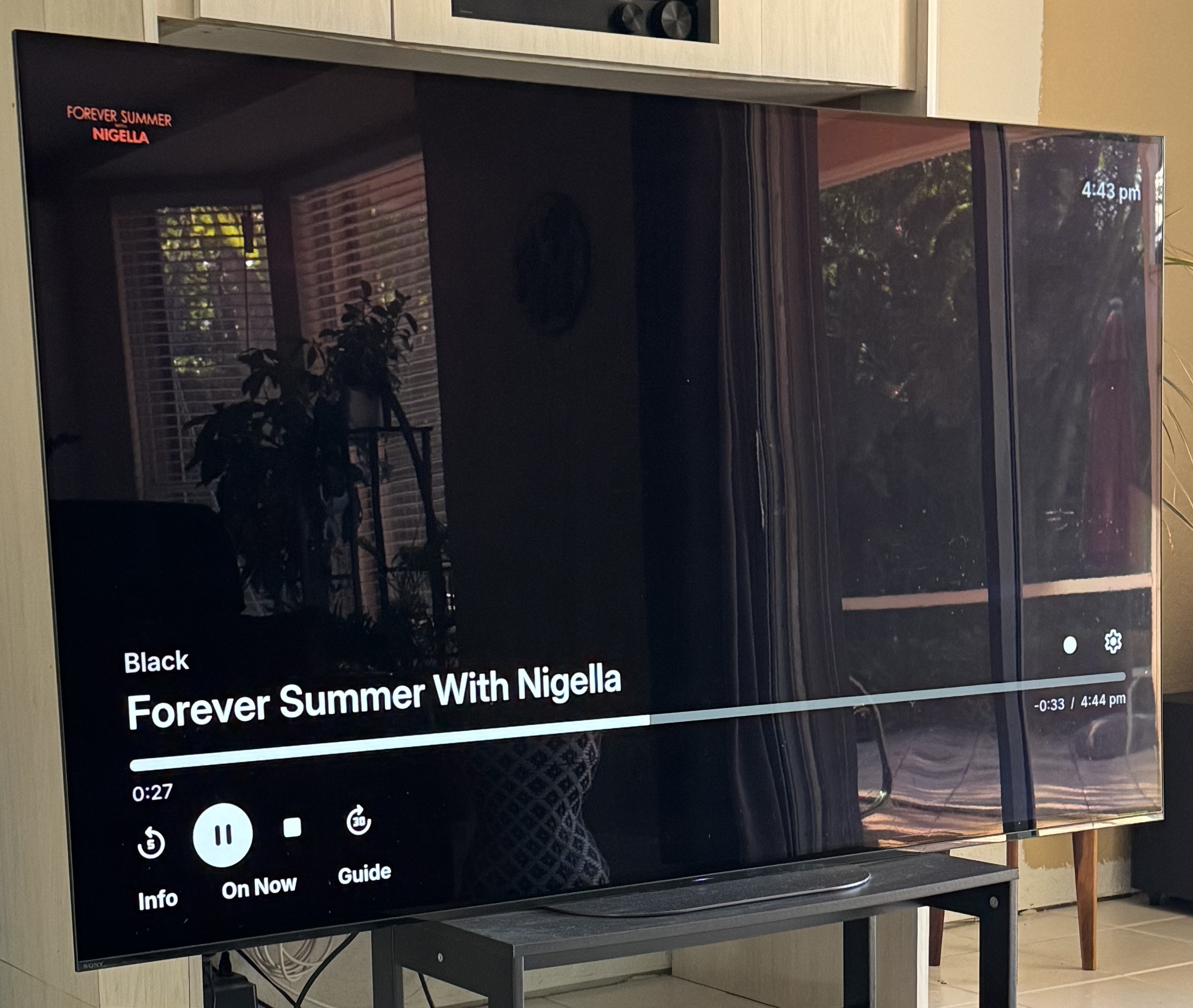

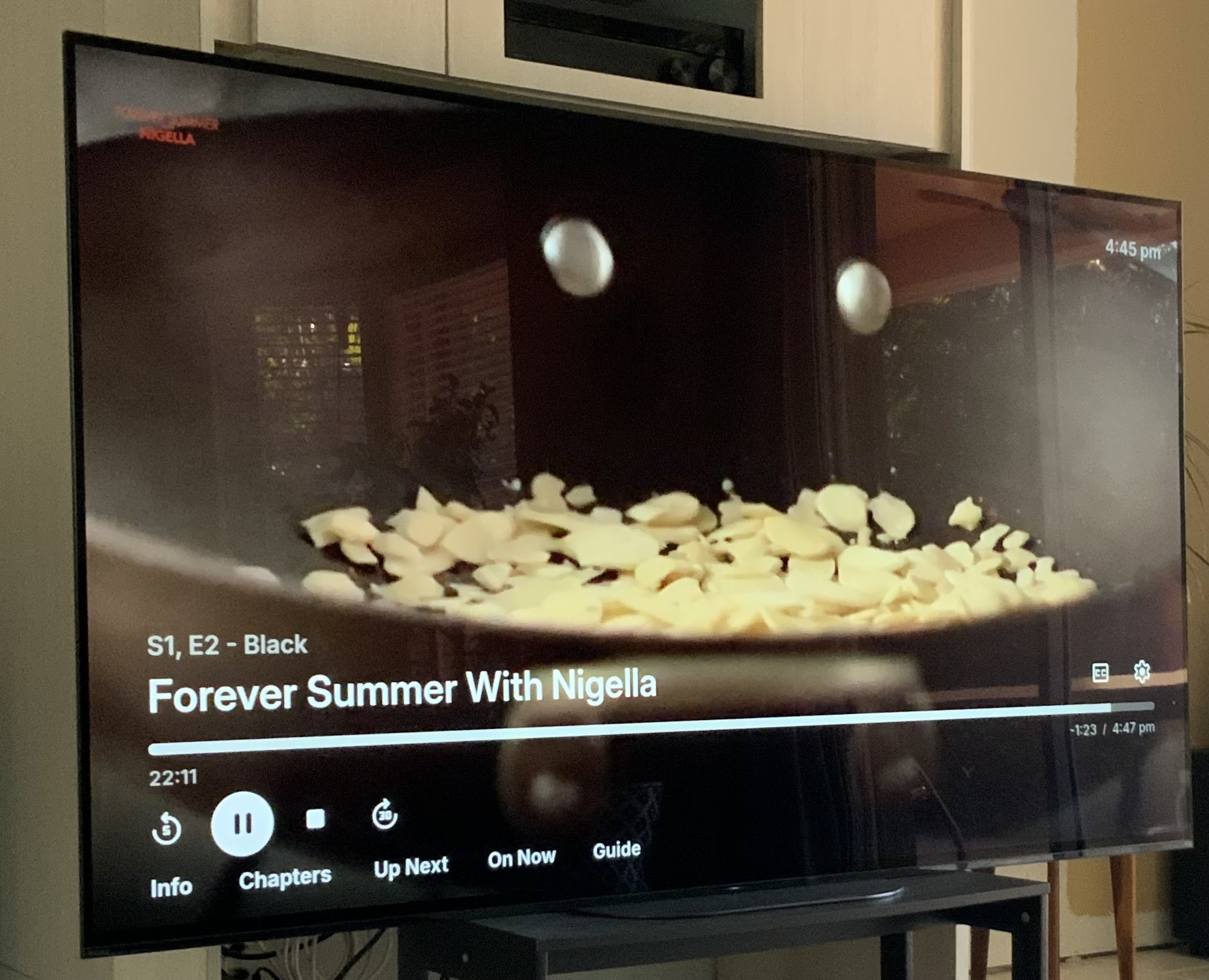

hstamas 179 Posted October 13 Author Posted October 13 @pünktchenif I let the Nvidia shield sit turned off for any length of time and fire up Emby this happens. Can reproduce 100% of the time. see the screenshots to illustrate what I’m talking about above. Notice the program title.. this does not ever happen when I revert to the AndroidTV app. also note, this is not channel specific. Happens on all channels I have set up, one of which I have set up as “random shows/ordered episodes”.
pünktchen 1371 Posted October 14 Posted October 14 I'll try to reproduce it, but i do not think the guide display issue has any impact, because the plugin gets the program entries from the database, not from the client. It's more likely a general playback problem when using remote playback commands while something other is still playing. We had this problem already with the Apple TV clients i think.
hstamas 179 Posted October 14 Author Posted October 14 10 hours ago, pünktchen said: I'll try to reproduce it, but i do not think the guide display issue has any impact, because the plugin gets the program entries from the database, not from the client. It's more likely a general playback problem when using remote playback commands while something other is still playing. We had this problem already with the Apple TV clients i think. Just note that I am the only one playing content so it never more than 1 stream at a time in my situation. its not odd that as soon as the Android app has the proper season and episode info to display, video starts playing properly?
pünktchen 1371 Posted October 14 Posted October 14 10 minutes ago, hstamas said: its not odd that as soon as the Android app has the proper season and episode info to display, video starts playing properly? No. Because you get the correct info after a force close of the app which also resets the playback engine or the websocket connection. One of those two things is the culprit i think. 1
