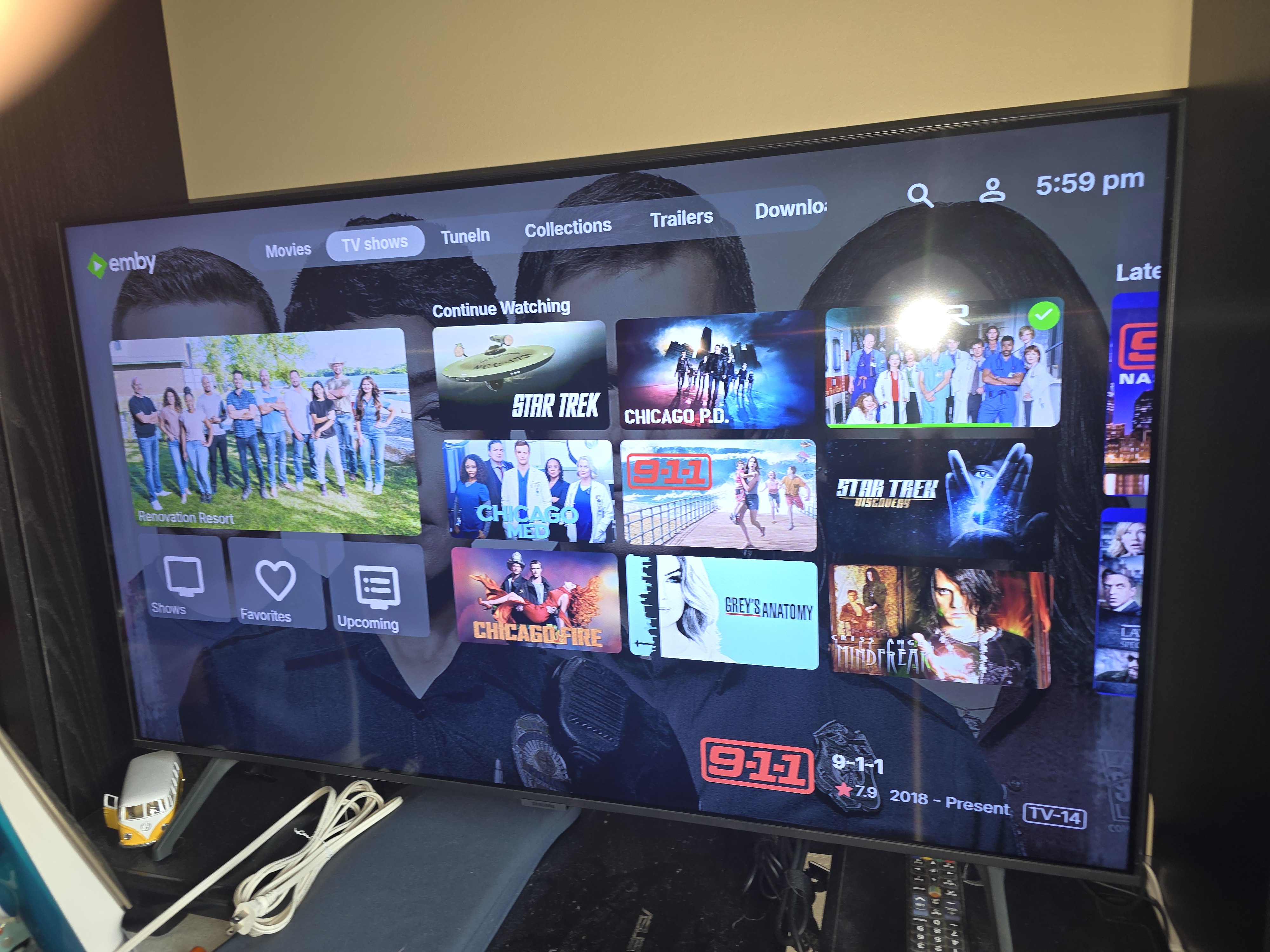

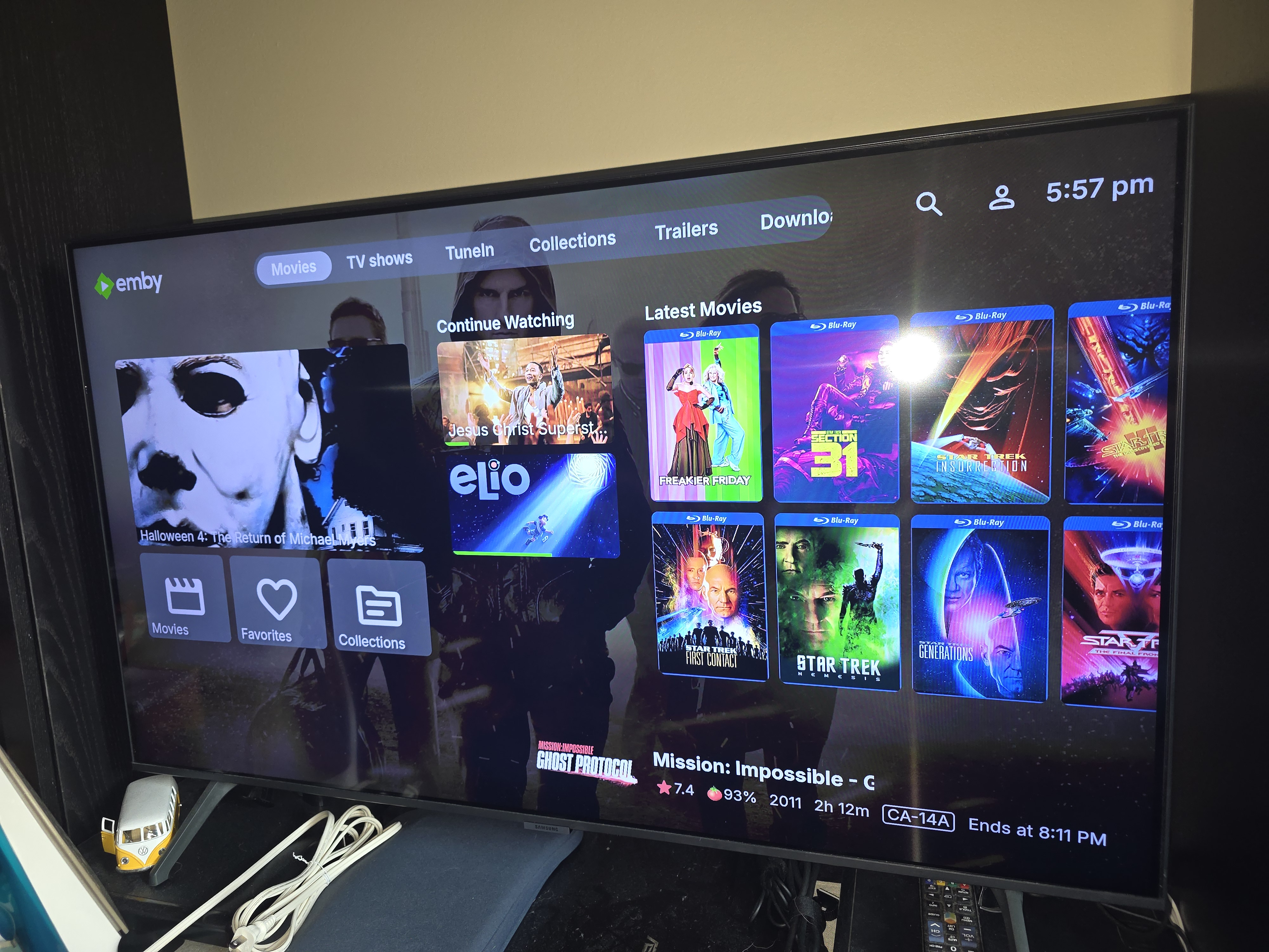

Rythal 1 Posted October 11 Author Posted October 11 Here's 2, one from Home with 'Movies' selected, you can see from the bg image and bottom text that Mission: Impossible Ghost Protocol is selected, but the screen never shifted to the right for the tile/box to be visible. Second one is from Home with 'TV Shows' selected, my selection is on 911 from under Latest but the screen never shifted to show the latest section.
Luke 41257 Posted October 11 Posted October 11 Hi that's strange. It seems to be working OK in my testing. We'll look into this. Your workaround for now would be to use the vertical home screen.
