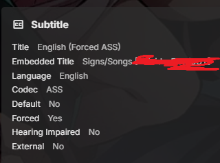

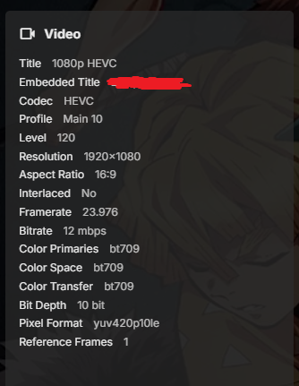

quiet_blueberry 1 Posted October 10 Posted October 10 Hello, I recently got a new TV (LG65C5) and bought the NVIDIA Shield Pro TV 2019 for that. Because the TV does a much better job at upscaling than all the Shield options I enabled "Match video resolution" and "Enable display refresh rate switching" in the Emby Android app. But when playing 1080p content the app sometimes crashes (I guess around 30-40% of the time) when starting to play. I searched in the internet and tried some things, including disabling HDMI-CEC, turning off "Match content color space", switching the HDMI from 1 to 2 (which is the eARC/ARC thing) and also disabling "Enable display refresh rate switching" to only have the "Match video resolution" enabled but none of that worked. Interesting thing is that I also got smarttube installed and also enabled the matching there and that works without any crashes with 1080p content (I confirmed in the settings that smarttube did indeed switch the resolution when playing, but no crashes occured). I've enabled the debug logging and let it crash, I've attached it the file. Do other people also have this issue or this is a known issue? emby_android_1760051283131.txt

quiet_blueberry 1 Posted October 26 Author Posted October 26 Hello, I downloaded the arm64 version from the website and installed it on the shield. I can confirm that the version in the emby app is showing 3.5.13. Sadly, the crash is still occuring. I had debug logging enabled and attached the log file. I also attached the media info that I tried to play. I hope it helps. emby_android_1761485240675.txt
