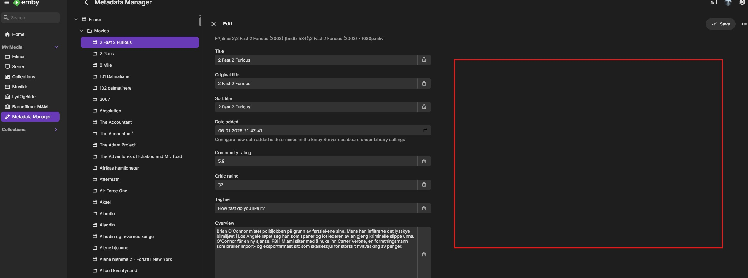

PeteGul 34 Posted October 28 Author Posted October 28 Hi I ended up using tMM to mass add my tag in the .nfo file. So now the tag i searchable. And my better half's collection, she will fix it her self. I don't use tMM to download anything, just create .nfo and rename my files and folders with tmdb id and videoformat (resolution). Just so Emby find it easy and not so much mess in the filenames etc. Haven't tested it much, but the built in Metadata Manager in Emby looks good and works quite nice. But for me it lack the possibility to change filename to the scraped name and the bulk edit. Or is this somewhere I haven't found it? Would also be nice with a search in the Metadata Manger, that don't "jump out" of the manager, alongside with the images on the right side of the metadata (red making) as an easy way of changing them etc. Else, love for Emby 1
