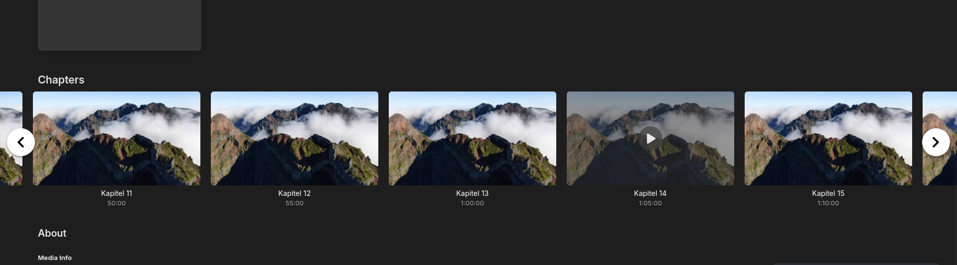

BMNBMN 2 Posted June 10 Posted June 10 i have noticed that when i copy films into the library, emby recognizes the film much too quickly (while the copying process is still running) and then all chapters have the same picture. do i always have to shut down the emby server before expanding the library or is there another solution?

BMNBMN 2 Posted June 12 Author Posted June 12 is there a way to force the recreation of chapters for existing films? i noticed it far too late and now have a lot of these entries.

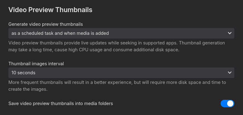

Solution Happy2Play 9435 Posted June 12 Solution Posted June 12 8 hours ago, BMNBMN said: is there a way to force the recreation of chapters for existing films? i noticed it far too late and now have a lot of these entries. Not positive but thought Refresh metadata did that. What is your library "Video Preview Thumbnails" settings? 1
BMNBMN 2 Posted June 12 Author Posted June 12 (edited) i changed the "generate video preview thumbnails" to as a scheduled task only which should do the trick for future films. tried to refresh the metadata but did not help. i tried to delete the .bif file and start the video preview thumbnail extraction but all thumbnails on this film are black now. edit: you are right, refresh metadata did the trick if you delete the .bif file first. thank you very much Edited June 12 by BMNBMN 1
