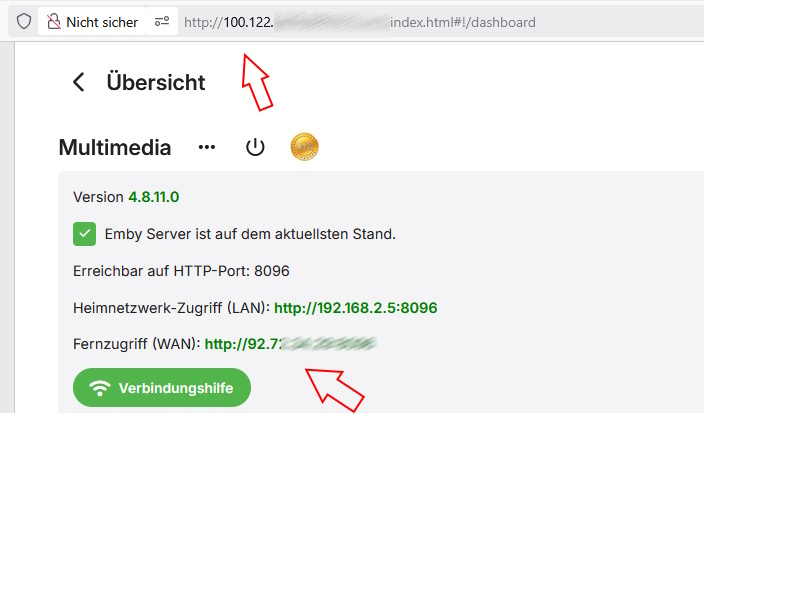

I am new with Emby and have installed Emby at QNAP-Server. At the Home-Network the function is fine, but i can't connect to emby from extern with Emby connect. I habe seen, that the WAN-Adress at the Emby-Dashboard is not correct (I use also Tailscale). If i connect via Browser from extern with the Tailscale WAN-Adress th function is OK. With the WAN from the dashboard, it doesen't work. Have anybody an idea to correct them for using Emby Connect? Thank you
Hi, those are two different things in your screenshot. To determine your WAN ip address, Emby Server uses a service similar to whatismyip .
Maybe your WAN ip address was detected before TailScale was started?
In any event, you can always customize your remote address in Emby Server network settings.
