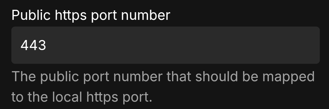

Set this to the port NPM is listening on.
The server will tell clients to use the port specified there when connecting from WAN using https.

fstropii
Thank you so much! That worked, I don't know why I didn't think to use that earlier, but thanks again.
