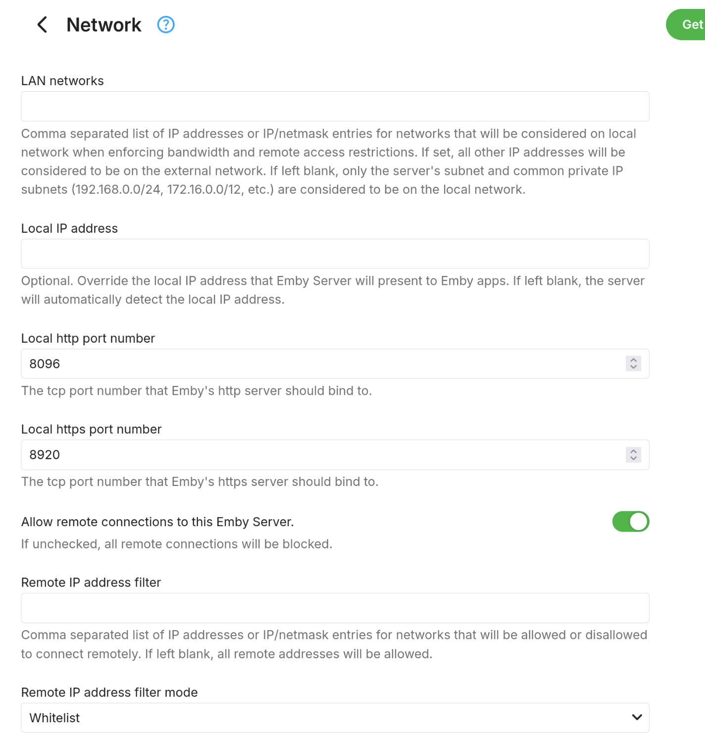

Luke 40018 Posted May 26 Posted May 26 Have you configured any emby server network settings? It's possible the server thinks it is a remote connection.

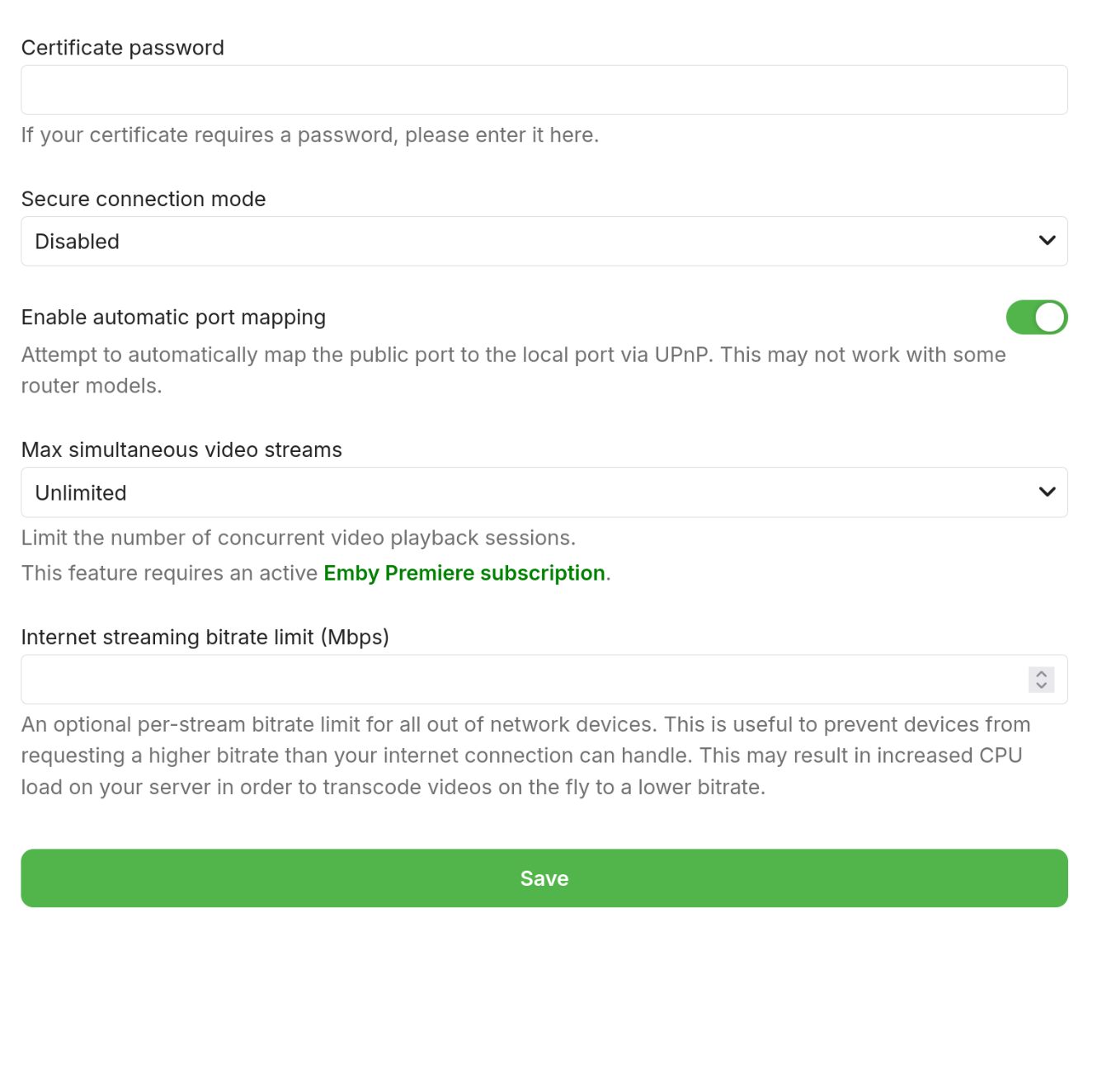

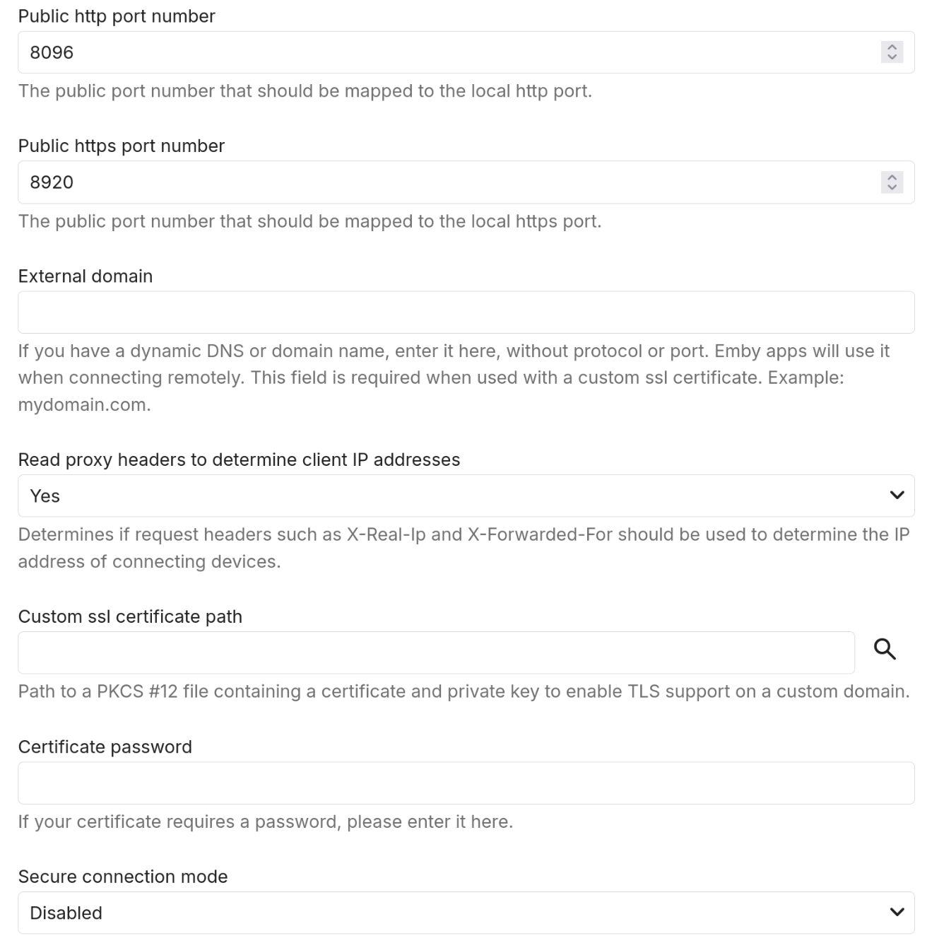

Darkel_91 1 Posted May 26 Author Posted May 26 Here are my Network settings. I don't believe I changed anything in there. The server IS connected to the Internet and accessible via remote proxy, but not via Emby server settings. And I'm using local IP for the TV, so it shouldn't affect the playback
Luke 40018 Posted May 26 Posted May 26 Do you know for sure that the TV is connecting via the LAN address?
Darkel_91 1 Posted May 26 Author Posted May 26 Yes, no incoming or outcoming internet traffic going through my router when using Emby. Just tried to switch off the remote connections in the server settings - it works better now with larger bitrate transcoding, but still no luck with direct play on the same file.
