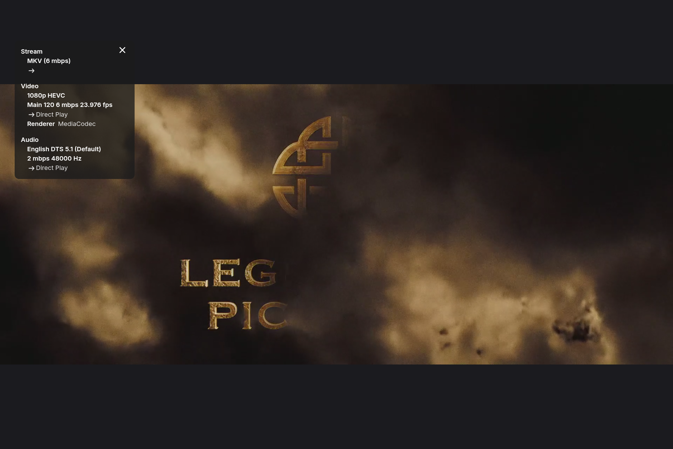

Capt.Insano 3 Posted May 22 Posted May 22 (edited) Android app version: 3.4.67 Android Server version: 4.9.0.60 Chromebook: HP x2 11 (all software up to date) Issue seems to happen when playing x265/HEVC videos only, when videos opened they play way faster than they should even though speed option is set to x1 Normal. Problem does not happen if I use Chrome browser on my Chromebook or even if I use the Emby for Android TV app (Navigation of Emby for Android TV app is difficult however). Screenshot of stats for nerds, screen recording of Android app, logs of Android app and server all attached. NOTE: I am currently travelling to a timezones +1 hour ahead of my server's timezone so time stamps may be 1 hour off. Please let me know if I can provide anything else to help. Screen recording 2025-05-22 14.07.56.webm embyserver.txt emby_android_1747915537799.txt Edited May 22 by Capt.Insano Clarification due to app/server timezone difference while travelling
