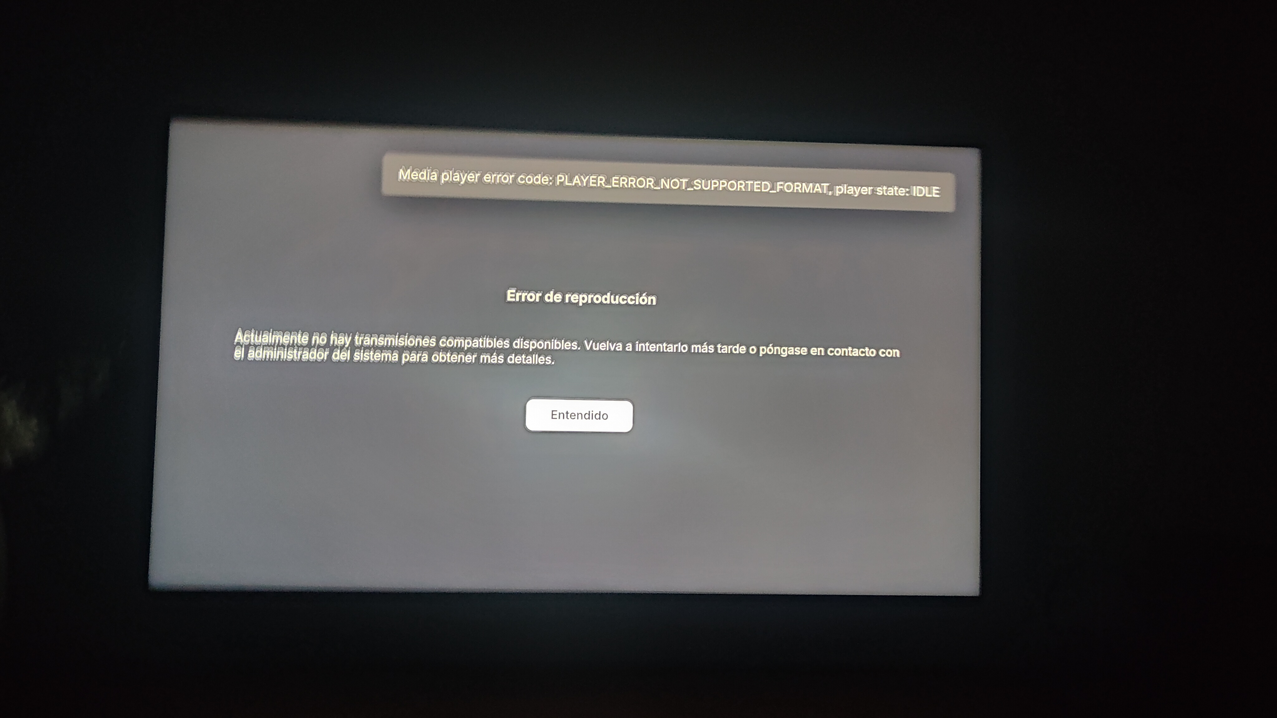

Mindows 0 Posted June 5 Author Posted June 5 no reproduce contenido Av1, salta el cartel de error media player, no compatible, he visto otros hilos en los que reproducen con televisor samsung de 2020 y gama mas baja. con Xbox Series X reproduzco sin problemas. It doesn't play Av1 content, the media player error message appears, not compatible, I have seen other threads where they play with a Samsung TV from 2020 and lower range. With Xbox Series X I play without problems.

Mindows 0 Posted June 9 Author Posted June 9 Hello, my TV checking its specifications decodes Av1 codec by itself, through emby direct playback there is no way, something must be wrong with the app, since if I ask for direct playback and it does not offer it the fault is not my configuration, due to hardware in the server I cannot do transcoding nor do I want to, I only want direct playback, I introduce the same files on a USB memory and connecting it to the TV, said file plays it without any problem, through Emby nothing at all, I get the media player error window. I need my TV to play this type of files because my nvidia shield is not compatible.

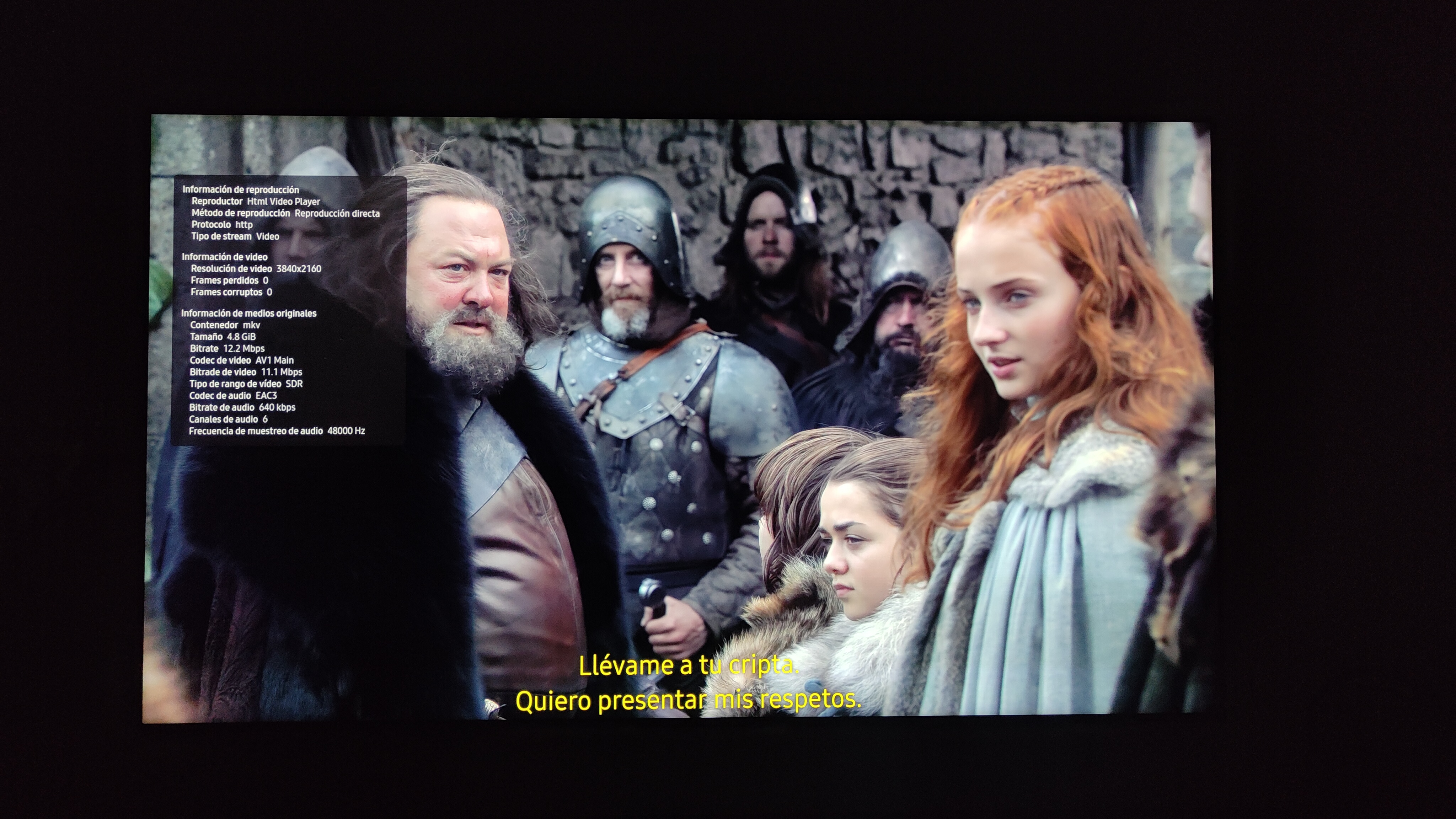

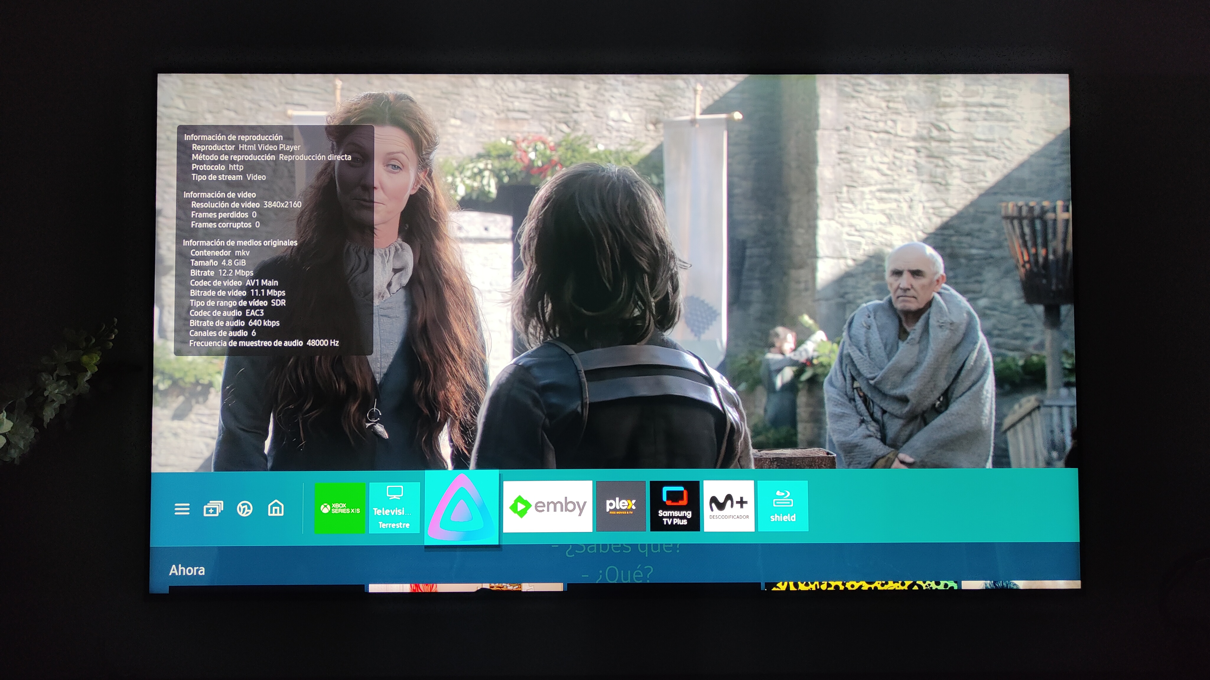

Mindows 0 Posted June 11 Author Posted June 11 I just installed Jellyfin on my Samsung TV manually and AV1 works perfectly. I was also surprised to find that the subtitles also work, which Emby doesn't either.

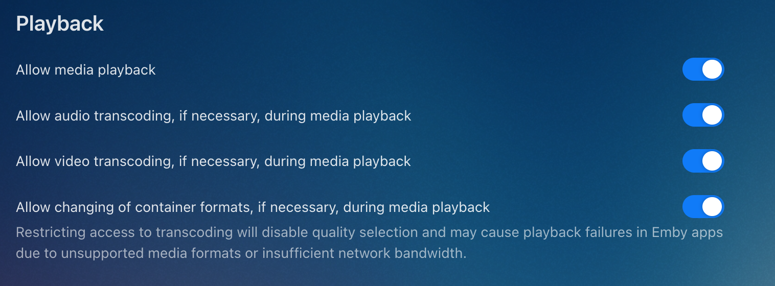

SamES 1003 Posted June 11 Posted June 11 (edited) 10 hours ago, Mindows said: Do you see any kind of error there? @SamES You really should not have these options off: 2025-06-10 18:56:11.977 Info App: User policy for Mindows. EnablePlaybackRemuxing: False EnableVideoPlaybackTranscoding: False EnableAudioPlaybackTranscoding: False Can you please turn them on (be sure to save the setting) then try again. This will also create the missing ffmpeg logs. Can you please attach them? Edited June 11 by SamES

SamES 1003 Posted June 11 Posted June 11 22 minutes ago, Mindows said: I have all of that disabled on all users. My friend with a Samsung 75S95C TV plays the content without any problems and I also have those options disabled. The issue is that those options can be required depending on the audio track and subtitles that are selected for playback. Please test and let us know the results. Adding the ffmpeg files will help us to better understand the media info and playback selections. BTW, why did you decide to turn these off - many things will work with them off, but also many will not and then you will have these problems. Emby is designed to always play the 'best' option but will use alternate methods when that is not possible. By disabling these options, you are preventing it from taking alternate actions when it 'needs' to. What issue do you think you are resolving by turning all of these off? If you have issues with them on, then that's something different we should investigate.
Mindows 0 Posted June 12 Author Posted June 12 I have activated everything you asked me and the image appears .... but everything is transcoded both image and audio which is EAC3 compatible with the television and even so it starts to transcode it, and the Av1 video is passed to hls h264, you cannot advance fluid minutes the image pauses buffering and until the image starts again, which seems like garbage to me ... because the devices are compatible they should not perform any use of transcoding or conversion. I deactivate everything again because in all these months I have not needed to have this activated at all and on my partner's Samsung TV AV1 works without activating this, apart from my reason for deactivating it was because of Direct TV that always transcoded me on any device and by deactivating it it transmitted directly
