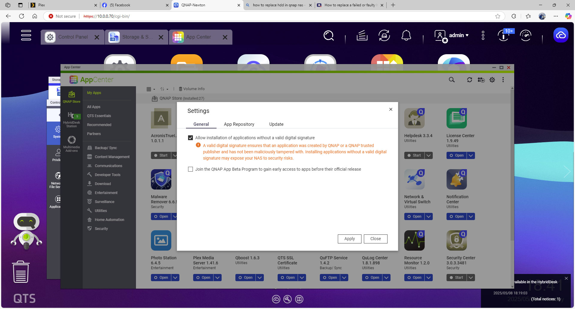

Luke 40017 Posted May 8 Posted May 8 Did you see this? Quote Before installing Emby on QNAP, you must have "Allow installation and execution of applications without a digital signature" selected and applied on the QNAP server at this location: App Center / Settings [gear wheel] / General. (This will produce a warning.) You must leave this setting on in order to avoid having Emby Server app shut down every day or so by the QNAP system (which would then require a manual restart of the Emby Server app).
CraigR4 3 Posted May 8 Author Posted May 8 yes, - i daresay it wouldn't have installed if it wasn't checked

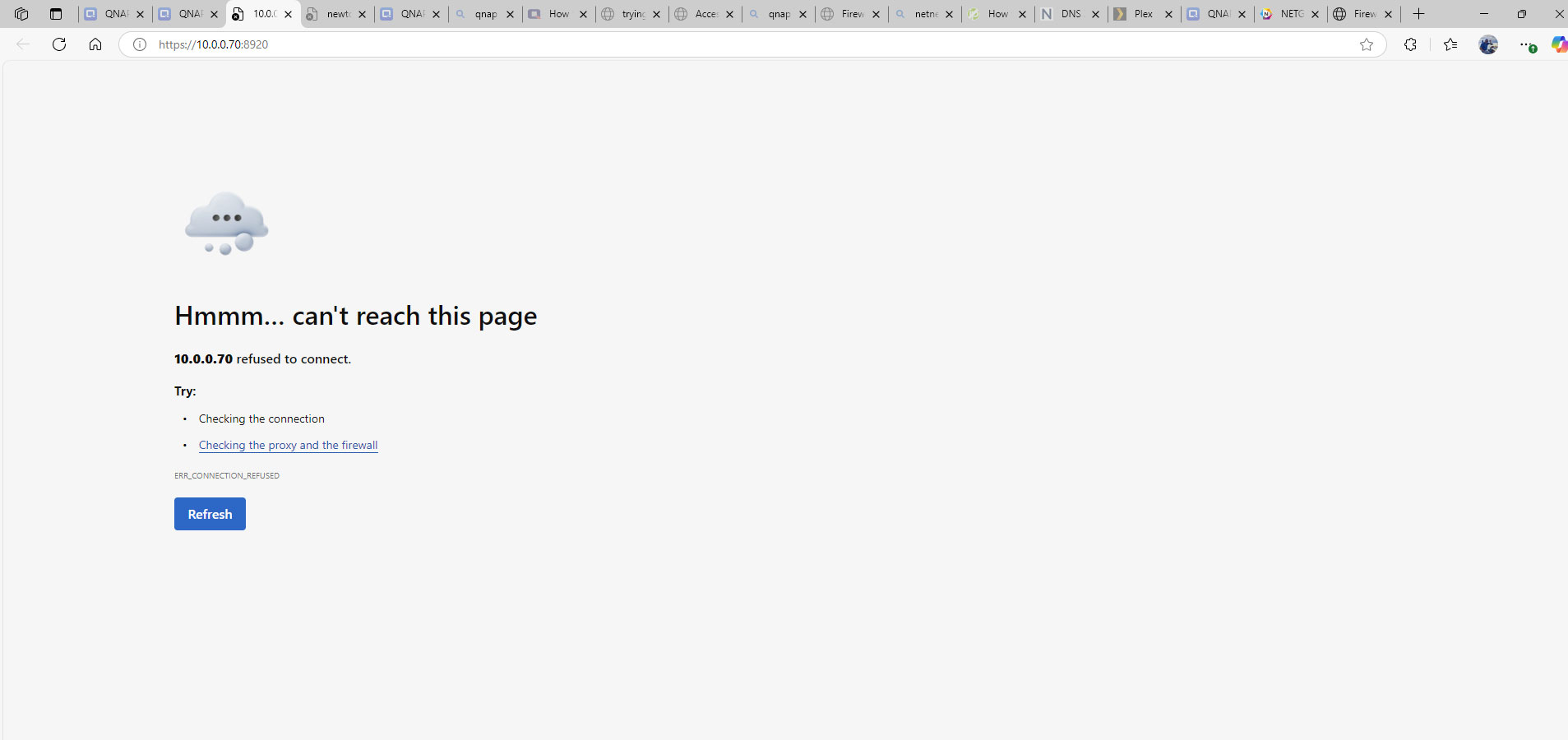

CraigR4 3 Posted May 13 Author Posted May 13 i uninstalled and then reinstalled version 4.8.11.0. the app is there, but when i try to open it i get refused to connect. Just for completeness, i also ensured port forwarding was set up for 8920
Luke 40017 Posted May 13 Posted May 13 7 hours ago, CraigR4 said: i uninstalled and then reinstalled version 4.8.11.0. the app is there, but when i try to open it i get refused to connect. Just for completeness, i also ensured port forwarding was set up for 8920 8920 is the https port. Did you setup https on your Emby Server? if not, then you'll need to use http with the 8096 port.
CraigR4 3 Posted May 14 Author Posted May 14 I haven't set anything up on the emby server - it wont load. The port number is the one used by the app by default. I changed it to 8096 in the url, but it makes no difference. I'll just give up and stick with plex. Thanks anyway
Neminem 875 Posted May 14 Posted May 14 If you use port 8096 then the url should be http://10.0.0.70:8096
Luke 40017 Posted May 14 Posted May 14 4 hours ago, Neminem said: If you use port 8096 then the url should be http://10.0.0.70:8096 8096 is the default port of Emby Server, so yes this is correct. @CraigR4
Luke 40017 Posted May 14 Posted May 14 6 hours ago, CraigR4 said: I haven't set anything up on the emby server - it wont load. The port number is the one used by the app by default. I changed it to 8096 in the url, but it makes no difference. I'll just give up and stick with plex. Thanks anyway @CraigR4but don't you want a personal media server and not one that puts all of your information into the cloud and sells it to the highest bidder?
CraigR4 3 Posted May 15 Author Posted May 15 i want a media server that works. if i can get emby to work, then great, however I have followed the instructions, installed it, tried both ports, and it refuses to connect. i am a little confused about how (or why) to set up https on a local network - i understand it for remote access, but for local access I'd be grateful if someone could explain
GrimReaper 4121 Posted May 15 Posted May 15 21 hours ago, CraigR4 said: The port number is the one used by the app by default. I changed it to 8096 in the url, but it makes no difference. Have you checked that the actual address in the address bar is http://10.0.0.70:8096, not https://10.0.0.70:8096?
