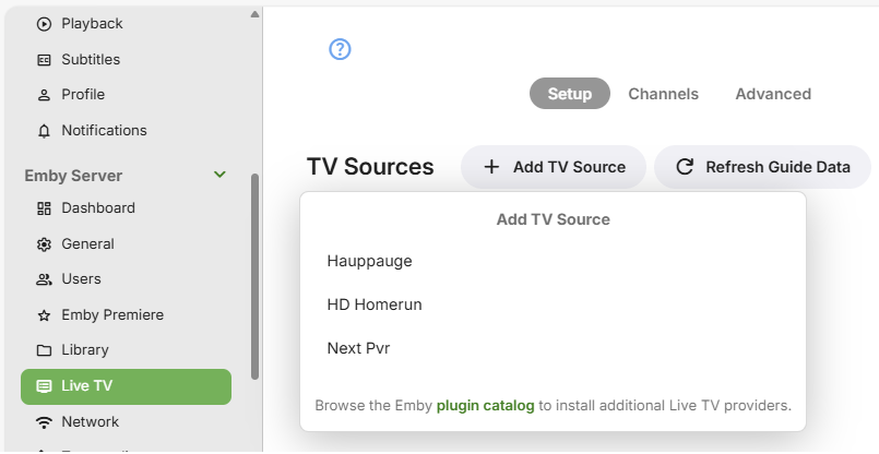

TugboatBill 16 Posted May 5 Author Posted May 5 When I first started on adding Next pvr neither m3u Tuner nor Next pvr were options in tv sources. All I had was HD Homerun. When I added the NextPVR plugin then (and only after restarting the server) Next pvr was a possible selection.

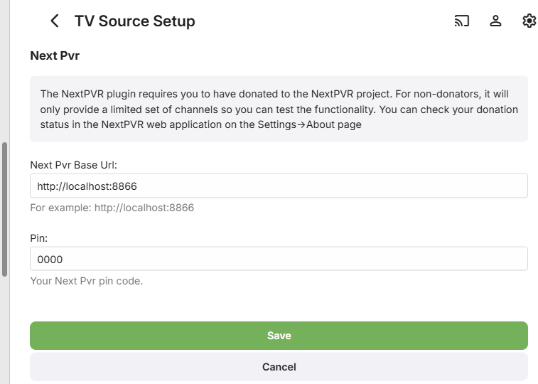

Solution sa2000 386 Posted May 5 Solution Posted May 5 27 minutes ago, TugboatBill said: When I first started on adding Next pvr neither m3u Tuner nor Next pvr were options in tv sources. All I had was HD Homerun. When I added the NextPVR plugin then (and only after restarting the server) Next pvr was a possible selection. You would need to restart the emby server after installing a plugin. This need to restart the server shows on the dashboard as well. It is mentioned on the NextPVR plugin description screen. it is also mentioned on the Plugins Management support document Just did a test and after restarting the server after installing NextPVR plugin, it did appear as a source. I see that it is not configured through the m3u plugin - so we will need to make further changes to the support document Clicking on NextPVR as source, shows which does mention limitations for non donators
