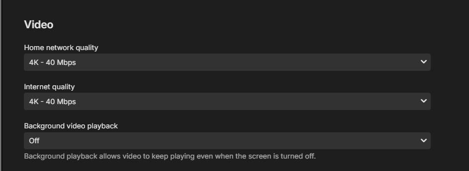

MrJohnW1ck
so if i increase the playback quality for the user will this issue be fixed
Currently using 4k 40mbps one where i was getting the error so kindly advise if i need to turn on transcoding or inncrease quality

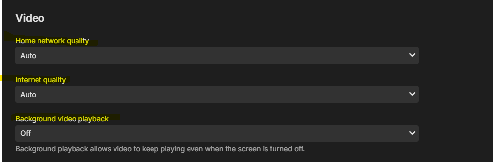

MrJohnW1ck
after checking it was the apps quality setting which was giving me the error now i changed the quality to auto  for both home and remote now its working
