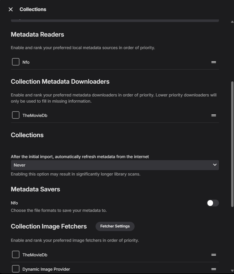

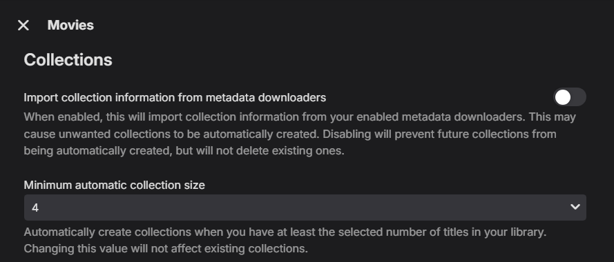

As a note, I've tried to disable Collections auto-creation, but they are still being created. Not sure if that has anything to do with it.

I've refreshed all metadata for movies so they no longer generate collections and that has helped, no more hanging on full library scans.
