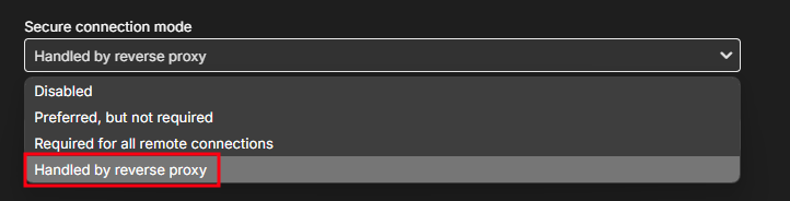

Try this under Emby network settings.
Thats how I do it, just with NPM
goblin2k3
Already did that, but thank you.

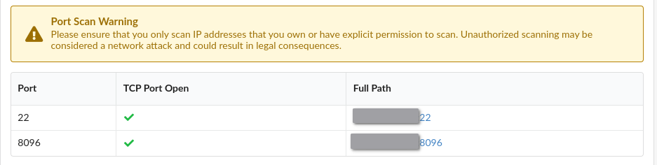

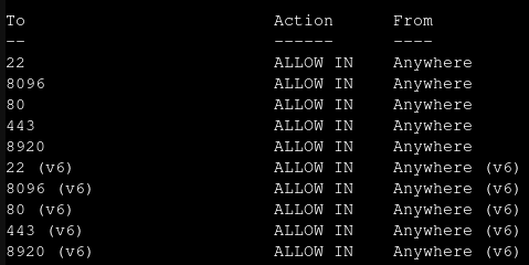

I should probably mention that currently Zoraxy passes requests to port 8096, as for some reason, port 8920 is unusable, although it is definitely opened. Changing the local ports (e.g. to 80 and 443) will make emby inaccessible, even though I opened these. Zoraxy's port scanner will always show only port 8096 as open and only, if it is used by emby. Otherwise it will show no open ports (besides the ssh port 22).
