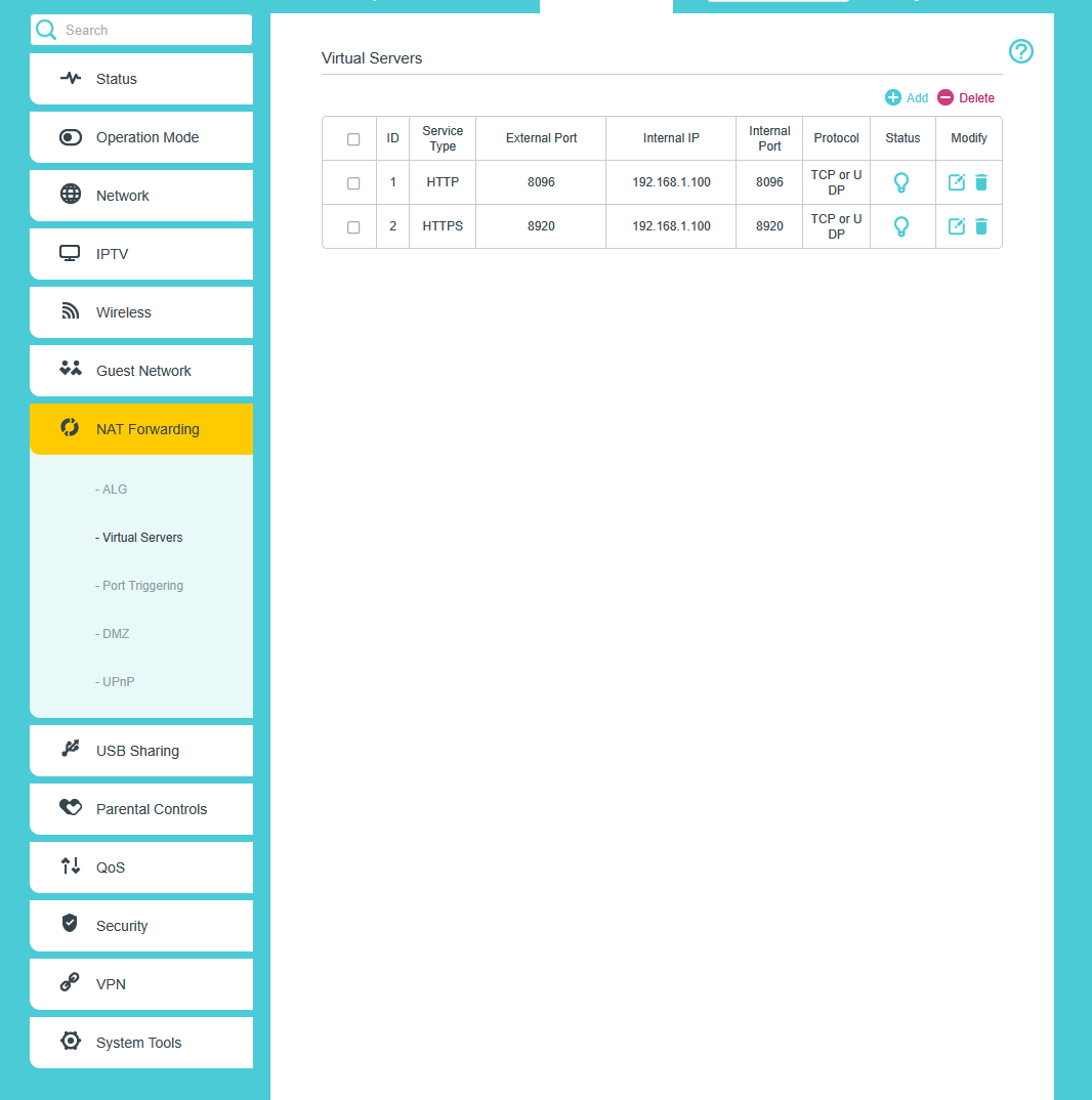

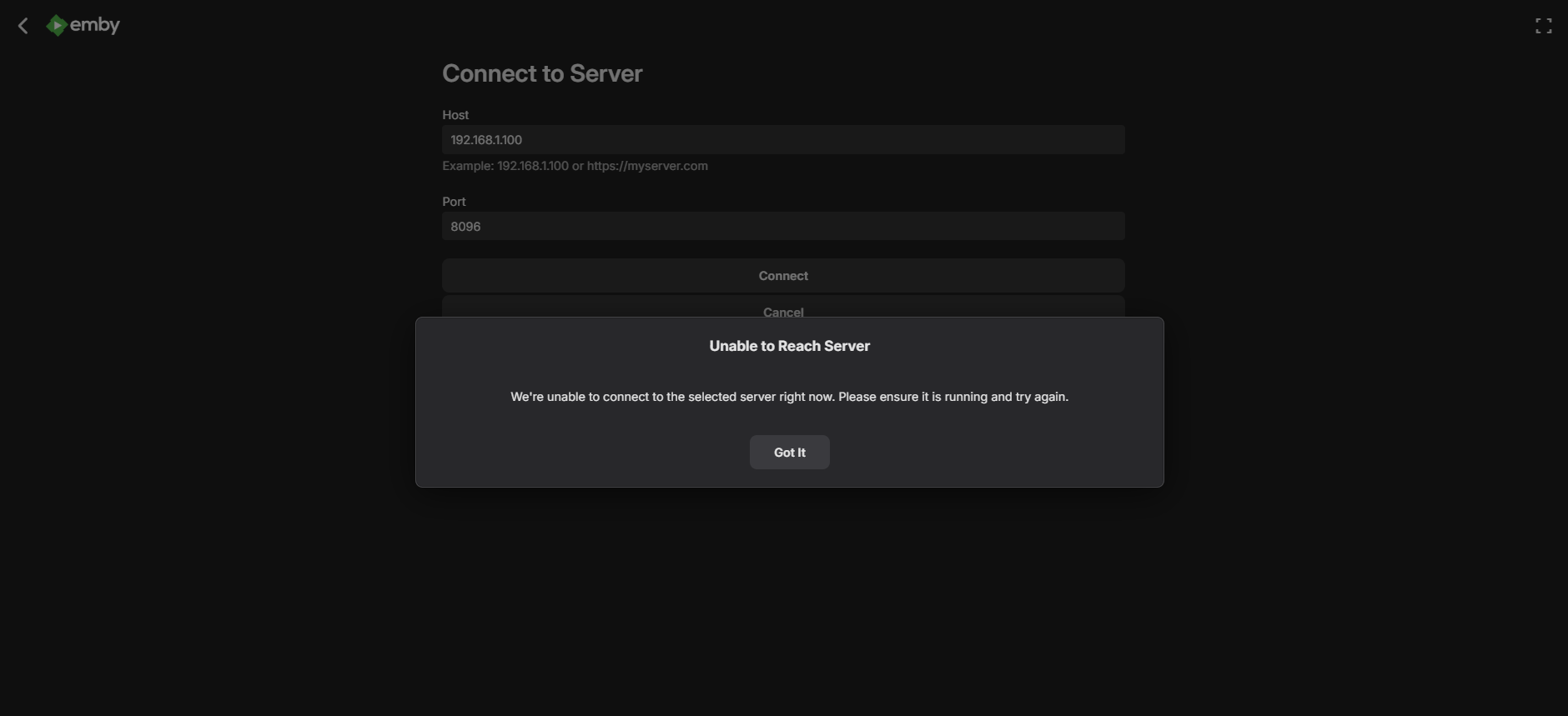

numetalfan89 1 Posted April 2 Author Posted April 2 12 minutes ago, Luke said: Hi there, what exactly happens when you try to connect? Can you show us how you set up port forwarding? Thanks for the quick response, here's a screenshot of my port forwarding setup, and one of what happens when I try to connect to the server on my hotspot. I'm feeling like I'm not using the correct IP with the port forwarding.
Luke 39992 Posted April 2 Posted April 2 Well that looks like your LAN IP. You wouldn't use that to connect remotely. You should be connecting remotely using your remote address.

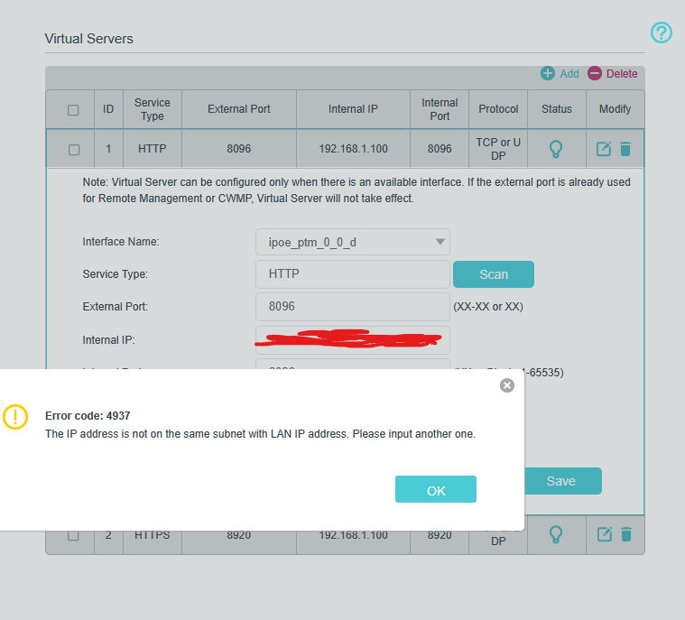

numetalfan89 1 Posted April 3 Author Posted April 3 10 hours ago, Luke said: can you please show a screenshot? Thanks. The IP that I've scribbled out is the one that's shown on my emby dashboard for the Remote (WAN) access IP.
Q-Droid 878 Posted April 3 Posted April 3 Does the Internal IP on the router port forwarding page match the LAN IP of your Emby server? If they match then you don't need to change port forwarding from what you show in the first image in this thread. The internal IP is the correct value there. When you connect to your server remotely you need to use the WAN IP that is shown on your server dashboard. It might be confusing that the "help" text also matches your server LAN IP, ignore that. Also if you're not running HTTPS on your server, which is most likely, then you need to use the HTTP URL for Emby connect, not the HTTPS URL. This can be a challenge because most browsers will automatically redirect to HTTPS unless you disable/override that feature.

Q-Droid 878 Posted April 4 Posted April 4 (edited) 11 hours ago, numetalfan89 said: Yeah they don't match, and when I put that IP that's on emby into my port forwarding settings, it hits me with a Error code: 4937 The IP address is not on the same subnet with LAN IP address. Please input another one. Something odd about this. Are you running a VPN client on the Emby host? Is 192.168.1.100 a different machine and if so then what is the LAN subnet? Is the router not allowing it because the IP is not in its DHCP range? Edited April 4 by Q-Droid
