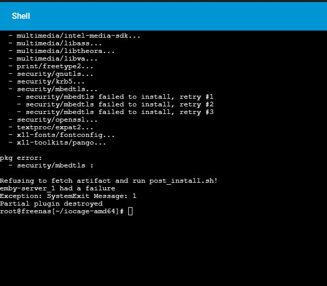

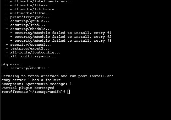

cgcmgr 21 Posted March 22 Posted March 22 Hi everyone, Looking at my, Last Post, updating to Emby version 4.8.11.0 broke my Emby server. I decided to delete the Jail and manually create the new server using the commands below. This is the way I have always done it. The creation errors out with the attached error. Once again, it has something to do with mbedtls. cd iocage-amd64 iocage fetch -P emby-server.json dhcp="on" ip6="inherit" allow_mlock="on" --branch master iocage set plugin_repository='https://github.com/MediaBrowser/iocage-amd64.git' emby-server_1 Is there a new command that will use the new mbedtls2? Or a command that I can use to create the new server? Thanks, Chris

cgcmgr 21 Posted March 23 Author Posted March 23 Hey Luke, I honestly don't know. The steps I used above I had gotten from a post a year or so ago. I'm not even able to get to this step iocage set plugin_repository='https://github.com/MediaBrowser/iocage-amd64.git' emby-server_1 as the error occurs when running iocage fetch -P emby-server.json dhcp="on" ip6="inherit" allow_mlock="on" --branch master. I currently have two two Emby servers and one is based on an older Jail, a 12.3 release. I was working on getting two identical servers on a 13.1 or higher Jail so that I can delete the 12.3. I'd use one server and have the other as a backup. Chris

cgcmgr 21 Posted March 25 Author Posted March 25 Thank, I do plan looking into Scale in the future, but right now all I use my NAS for is Emby. I have everything working the way I want it and all the images and metadata the way I want it. The reason why I have two servers is case something happens to one when updating it like it just did. You said I can still do this, referring to manually creating a Jail in Core. How would I do this if the command iocage fetch -P emby-server.json dhcp="on" ip6="inherit" allow_mlock="on" --branch master fails to create the jail due to not being able to install mbedtls? Are you guys working on a new emby-server.json? Chris

cgcmgr 21 Posted April 3 Author Posted April 3 Just tried Luke and got the same error. An issue with mbedtls. See attachment.

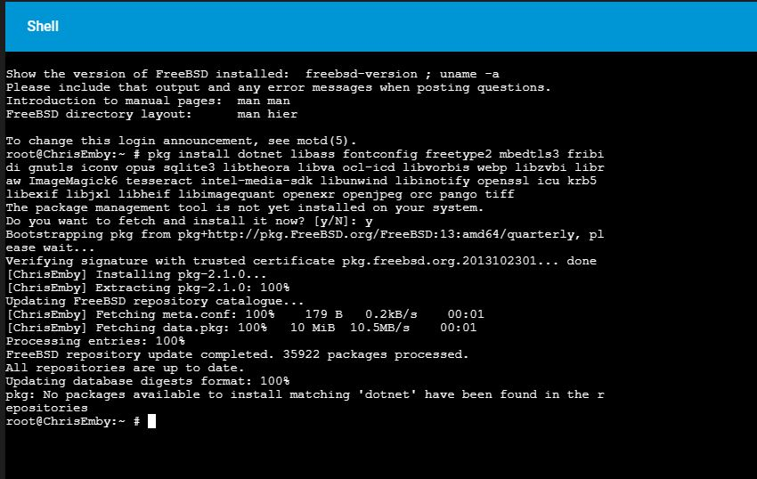

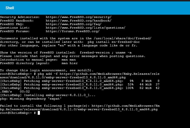

cgcmgr 21 Posted Friday at 07:22 PM Author Posted Friday at 07:22 PM Hi confy_server, So I tried installing without Sudo before the previous post and it did go through an install, but it didn't look like it installed any of the dependencies listed and failed on installing dotnet. See attachment #1. I then ran the command pkg add -f https://github.com/MediaBrowser/Emby.Releases/releases/download/4.8.11.0/emby-server-freebsd13_4.8.11.0_amd64.pkg I received a message that it couldn't install as it was missing dependency expat, see attachment #2. I then went though the pkg install for every dependency that it said it was missing as described in my post from April 12th. It eventually got to "missing shlib dependency libfftw3.so.3." Executing pkg install libfftw3.so.3 returns an error that it cannot be found. This is where I gave up. Am I using the correct pkg add command to install server 4.8.11.0? I just want to confirm, I should be running these commands in the Jail's shell, correct? Not in the TreuNas shell. Can anyone offer any insight or assistance? I can migrate to Scale, but I know I will lose the Jail and will have to install Emby and start all over. I do have a manual backup of my current 4.8.11.0 Emby server. Would I just be able to restore that and be good with all my movie's picture art and metadata? I'm not even sure where the location to copy it to is located in Scale since I always copied it to mnt/ChrisNas/iocage/jails/ChrisEmby/root/var/db in Core. I really don't want to migrate to Scale and lose everything, as it is currently the way I want it.
nmalinoski 1 Posted 19 hours ago Posted 19 hours ago The reason no packages are matching dotnet is because, by default in a fresh jail, no pkg repos are configured. It seems you need to create /usr/local/etc/pkg/repos/FreeBSD.conf containing (mostly borrowed from plugin-default.conf in my plugin-based emby instance): FreeBSD: { url: "https://pkg.freebsd.org/FreeBSD:13:amd64/latest", signature_type: "fingerprints", fingerprints: "/usr/share/keys/pkg", enabled: true } Then you need to run `pkg update -f`. After that, the install command should work fine. I'm not sure why these steps are missing from the Emby FreeBSD install guide.
