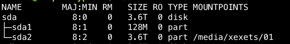

xexets 3 Posted March 22 Author Posted March 22 What do you mean by 'exactly'? The drive is an NTFS drive, via powered USB hub into the Pi. I have NTFS-3G on Linux and it automounts. Attached please find print out of lsblk. Findmnt returns: /media/xexets/01 /dev/sda2 ntfs3 rw,nosuid,nodev,relatime,uid and this is df -h:: /dev/sda2 3.7T 3.6T 57G 99% /media/xexets/01
