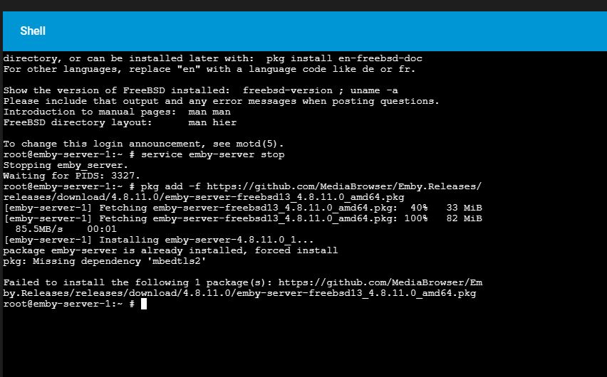

Hi everyone,
I decided to update my two Emby servers this morning form 4.8.10.0 to 4.8.11.0.
I started updating one server and it was missing dependency mbedtls2.  So I ran the command pkg install mbedtls2 and the dependency installed.  It didn't take too long.  I then ran the command
pkg add -f https://github.com/MediaBrowser/Emby.Releases/releases/download/4.8.11.0/emby-server-freebsd13_4.8.11.0_amd64.pkg
To update to version 4.8.11.0 of Emby.  It installed and updated fine and everything seems to be working properly.

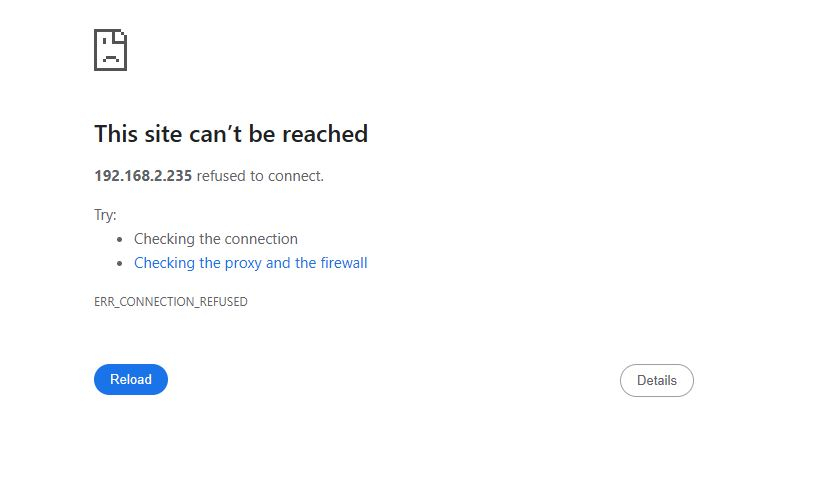

I then did the same for another Emby server that I have.  I also had to update the mbedtls2 dependency, but for some reason, this one went through a lot of downloading and installing and took much longer that the previous server.  It eventually completed and I updated the server to 4.8.11.0 using the same command as above.  For some reason, I can no longer access the server.  It shows as being up in TrueNAS, but it continues to refuse connection.  I have restarted TrueNas and restarted the Jail, but I cannot access the server.
Any suggestions?
Thanks,
Chris

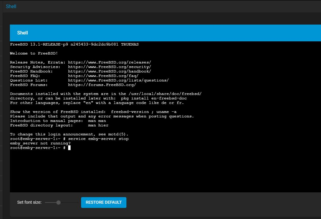

cgcmgr
I found something interesting.  I went through the steps again and accessed the server via the TreuNAS Shell and typed service emby-server stop.  Instead of saying "Stopping emby-server, it now says "emby-server not running?"
I figured I'd type service emby-server start to make sure it is running and it says "Starting emby-server."  I still can't access the server though.  I then tried to stop it again with the command service emby-server stop and I still get the response "emby-server not running?"
It seems as if the server is not starting.  I'm guessing that's why I can't accecss it.
Any suggestions?
Chris
