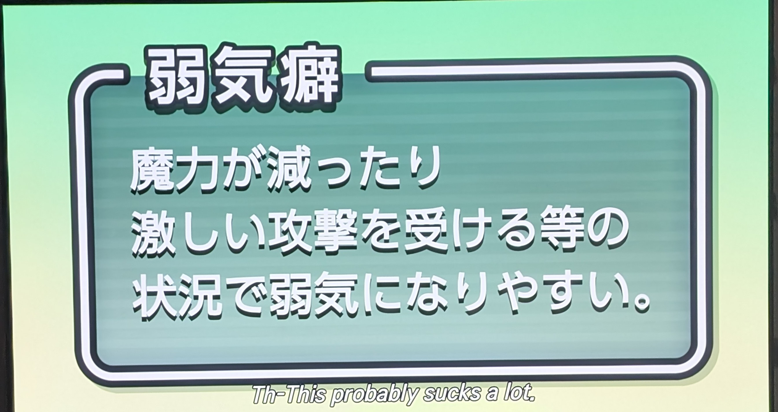

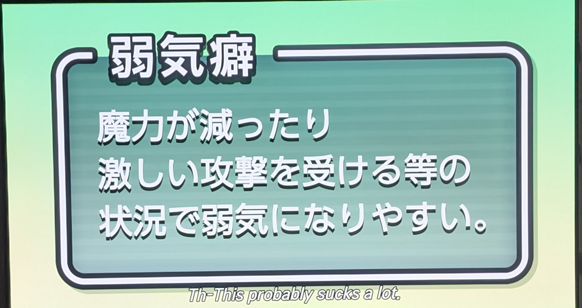

I have an ongoing issue with ASS Subtitle. I think I opened an issue on that in the past but I can't find it. What happen is part of the subtitles don't show when it's in ASS format. Sometime, it also add some artifact like /t2334534 or (ED) at the end of each line. It only happen on my LG TV (OLED65C8PUA). When I play through web browser, android, pc or anything else, the subtitle are there for these parts.

ASS formatting and rendering can require quite a lot of processing, often more than a TV device can provide, particularly when there are complex subtitle animations.
ASS support is not native on the TV, so they need to be processed and manually rendered by the Emby app.  Unfortunately, there are some limitations to what ASS commands are supported, and I suspect what you are trying to do may not be fully supported.

The issue from this thread is not that it's not playing. The issue in this thread is part of subtitles not playing. It happen often when it's other style, font or more graphical. Music animated subs always were hit or miss. If you check my screenshot, we can see what kind of subtitles are missing.
Outside of these, the subs work. Problem is I'm watching Dr. Stone so everytime there's extra subtitles (which is ten billion time each episode), I lose all subtitles while its suppose to be showed.

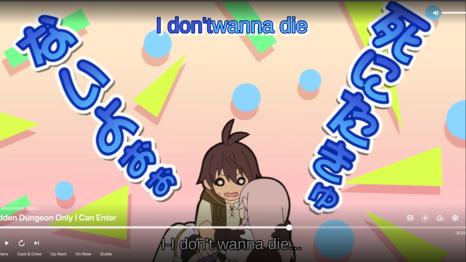

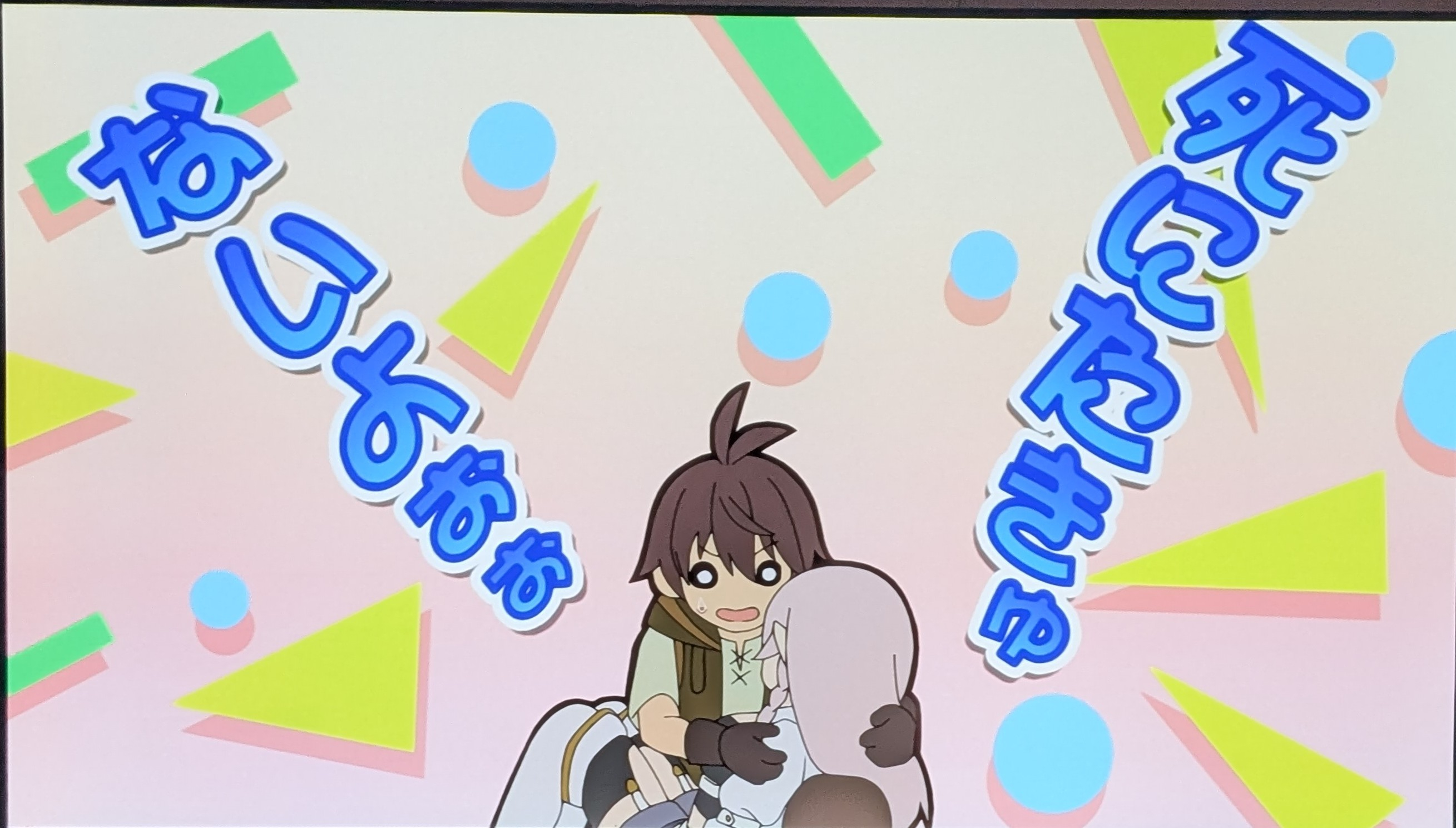

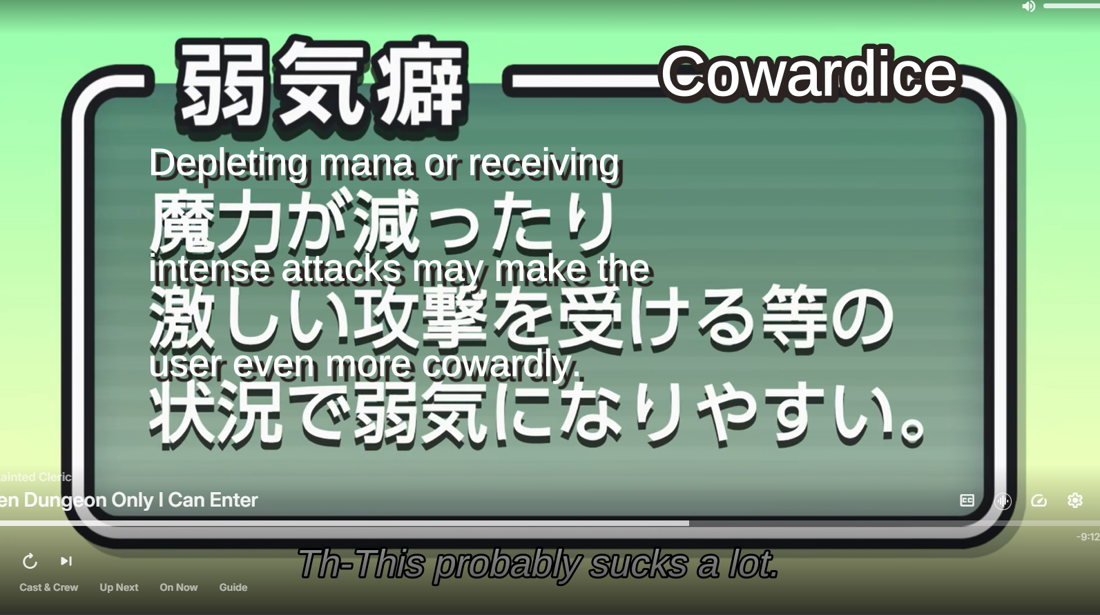

It seems the \fade(x,x) metadata in subtitles aren't always converted
LG:
PC:
