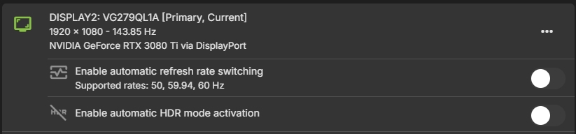

65535 13 Posted February 27 Posted February 27 (edited) v2.219.2.0 has a bug where it changes my refresh rate despite everything being disabled: Happens with SDR, HDR, 1080p, 2160p. It's changing to 24 hz, and I did try flicking the option on and off. EDIT: I don't know that the regression happened exactly on v2.219.2.0. Could've been earlier. Also it might have to do with this change : On 2/26/2025 at 4:10 PM, Emby Releases said: [Xbox] Limit refreshrate to 60Hz max I know it says [Xbox] but you can see there are no refresh rates listed higher than 60 hz in the screenshot above. logs.7z Edited February 28 by 65535
65535 13 Posted February 28 Author Posted February 28 (edited) I tested starting off from other refresh rates (set in Windows) and found that: 60, 75, 100, 120 = no switch, behaves as expected 144 = switches to 24 hz But this is definitely a regression as it was not doing that a month ago. Edited February 28 by 65535

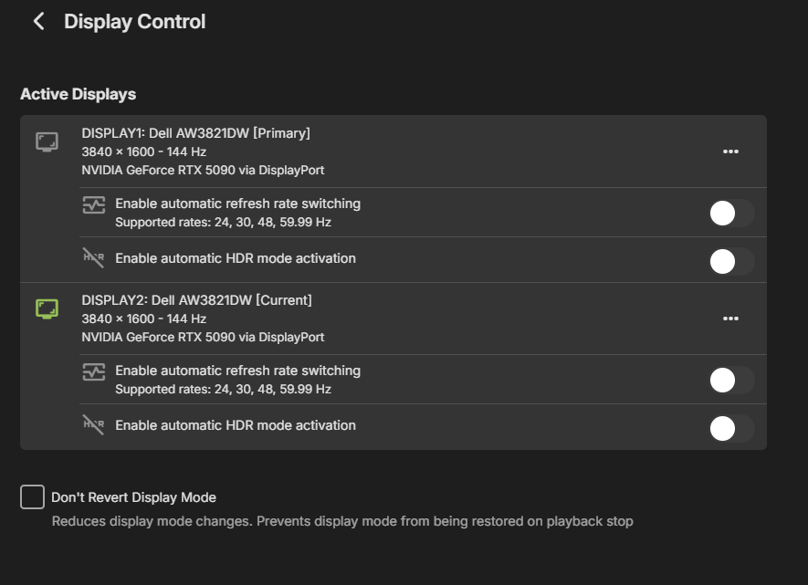

kron0s 23 Posted March 5 Posted March 5 (edited) This happens to me as well. Usually I am set to 144hz but when I play a video it switches to 24hz even though the option to enable auto refresh rate switching is disabled. Edited March 5 by kron0s

65535 13 Posted March 15 Author Posted March 15 11 hours ago, softworkz said: Only changes to the highest available refresh rate <= 120 Hz, regardless of the video being played This would be an improvement but: 11 hours ago, softworkz said: It does no longer try to revert it on playback stop I was hoping this was a typo or something, but it actually does leaves me at 120 hz regardless of the revert setting. Am I expected to change it back to 144 manually every time after using Emby? This is not a good experience. On 3/4/2025 at 1:13 AM, softworkz said: The app hasn't been made for and been tested with excessive refresh rates and hence it ensures that it is operating with a reasonable refresh rate. @65535 What you describe is intended behavior. The maximum rate might even be reduced in the future. Lowering to 120 hz temporarily is acceptable (if disruptive still), but reducing the limit further to 60 would be entirely unreasonable. 144 hz monitors were new 12 years ago. Honestly though I've never encountered a PC media player that requires changing the refresh rate for it to function. I don't think it's unreasonable to not want my screen to go black for several seconds every time I click on a video. Imagine if MPV or YouTube did that. Is this frustrating workaround really worth it? For what it's worth I see the same low 3D utilization and a 20% "Copy 1" utilization at 144, 120, and 60 in the high quality preset, and that's what I've been using at 144 before the update prevented it.

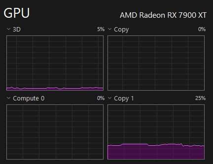

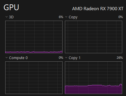

Thorman 2 Posted March 19 Posted March 19 (edited) 3 hours ago, softworkz said: Yes that's true, but it's a matter of the overall bandwidth to which the refresh rate is just one factor. Others are bit depth, screen resolution and chroma subsampling. An additional point of congestion is the HDMI standard. Even though I don't have outdated hardware, I can't even have a 4k@60Hz connection to the TV with HDR (it would be no problem with DisplayPort though). But that's just a side note. What matters is GPU processing. Could you compare the GPU load between 60Hz and 144 Hz under the following conditions: Emby App is set to the "High Quality" preset for video playback Display resolution 4k HDR mode enabled for the display What does any of this have to do with the fact that I paid extra for a 144 Hz monitor that me simply playing an emby video causes it to revert the refresh rate every time I watch a video? And the beta update is even worse with my 144 Hz monitor becoming a 120 Hz unless manually reset! WHY?!?!? All I want is for you guys to revert the update that caused this issue. I don't care that it uses more processing, but I definitely care that you guys altered my refresh rate even with disabling that setting! Can you please explain the reasoning here because I truly don't understand why you made this change? Like @65535 and @parkesto84 said On 3/15/2025 at 7:39 AM, 65535 said: Honestly though I've never encountered a PC media player that requires changing the refresh rate for it to function. I don't think it's unreasonable to not want my screen to go black for several seconds every time I click on a video. Imagine if MPV or YouTube did that. Is this frustrating workaround really worth it? 7 hours ago, parkesto84 said: I think everyone's question though is "why"? If I go change my refresh rate back to 165hz while the title is playing there are literally 0 issues so I'm not sure why Emby is switching my refresh rate even when this "feature" is disabled. It's super intrusive and a massive annoyance to reset. Edited March 19 by Thorman 1
