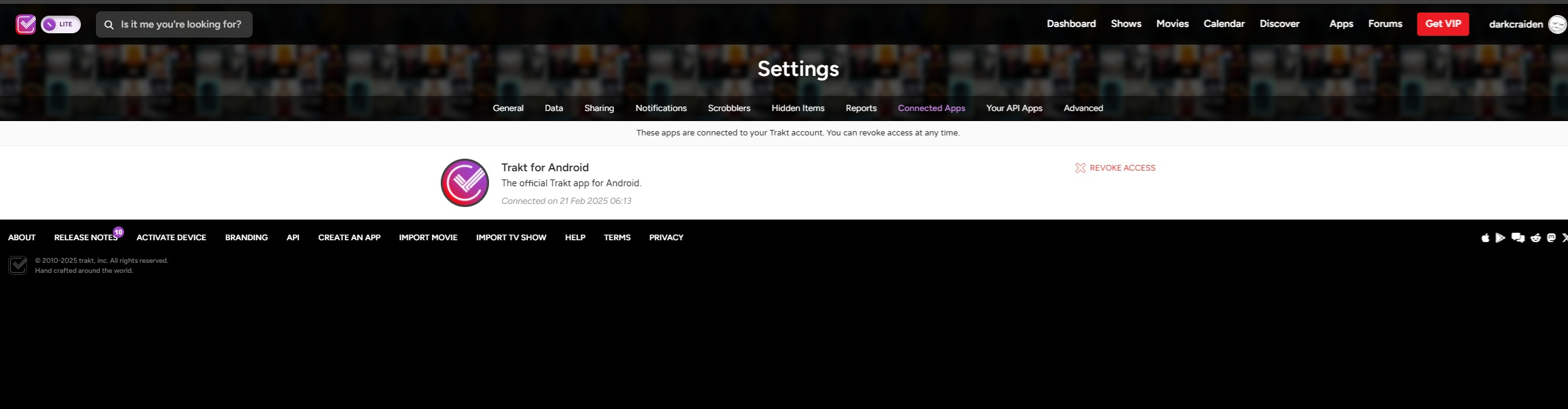

epicfail 2 Posted March 12 Author Posted March 12 I did it just again....server log attached. I also looked on the trakt homepage to see if emby has access again....there is no emby...screenshot below. embyserver.txt
Luke 41218 Posted March 12 Posted March 12 OK yes I can reproduce that. We are looking into it. Thanks.
