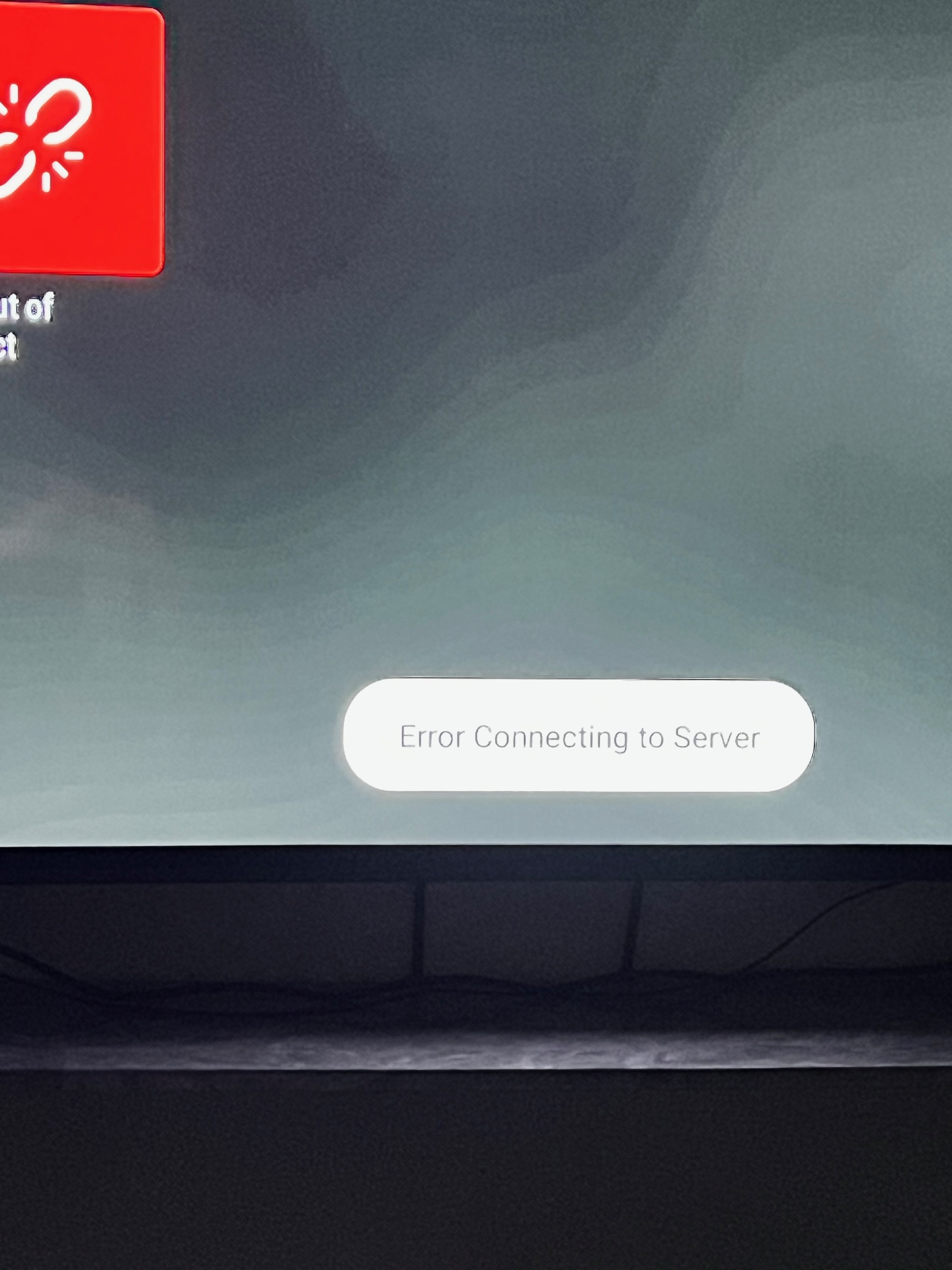

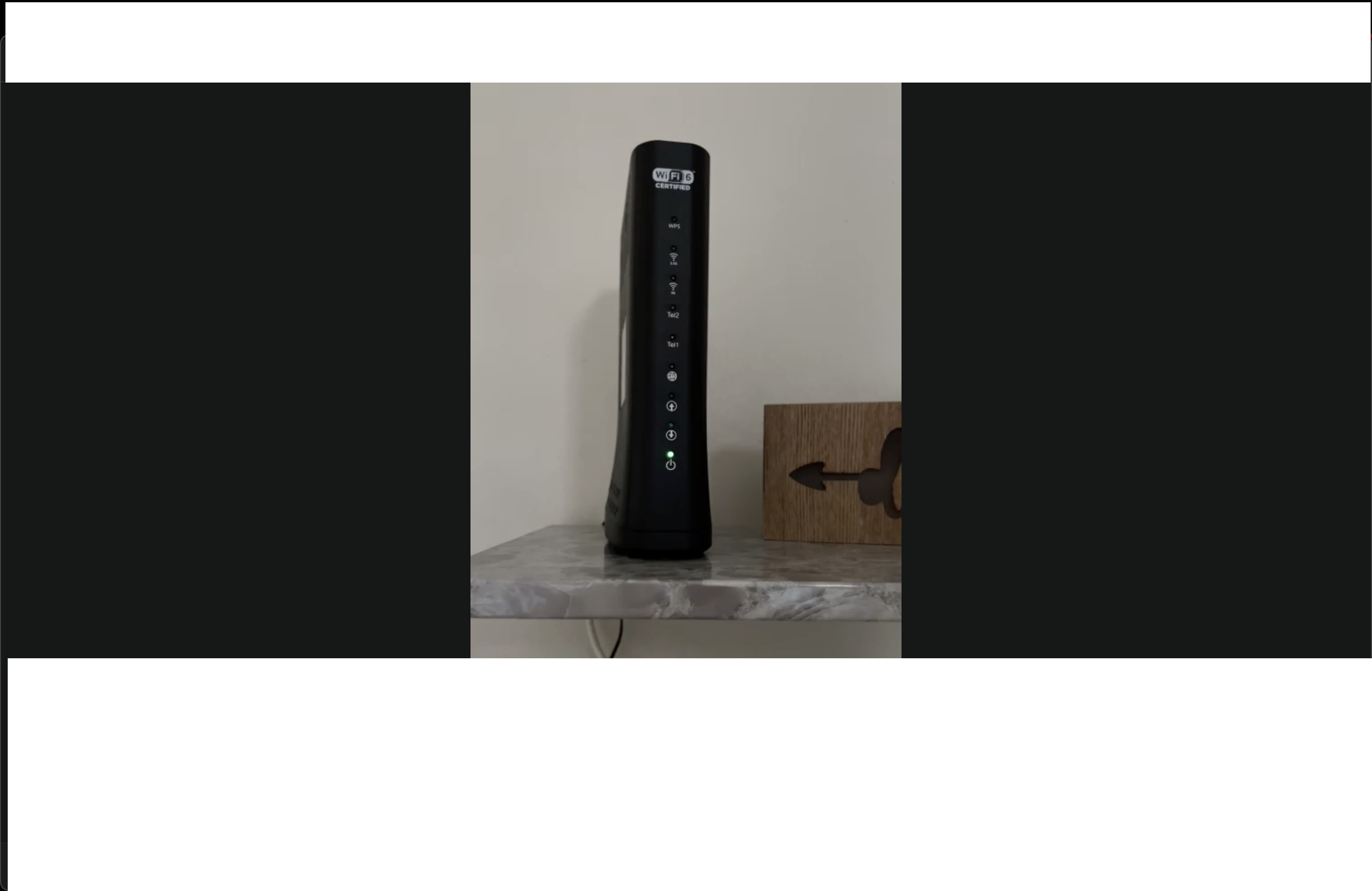

gensoto1990 1 Posted February 12 Author Posted February 12 (edited) Pretty much nothing. Again, I'm watching content fine on my Firestick, but the rest of my gear, zip. I mean, I even made another account on Emby and it didn't get me nowhere. Even Plex is in on the action meaning that it won't play anything either. Here's a photo: And here's a picture of the modem: So yeah, that's my predicament Oh, and I did try to put the IP manually and still nothing. Edited February 12 by gensoto1990

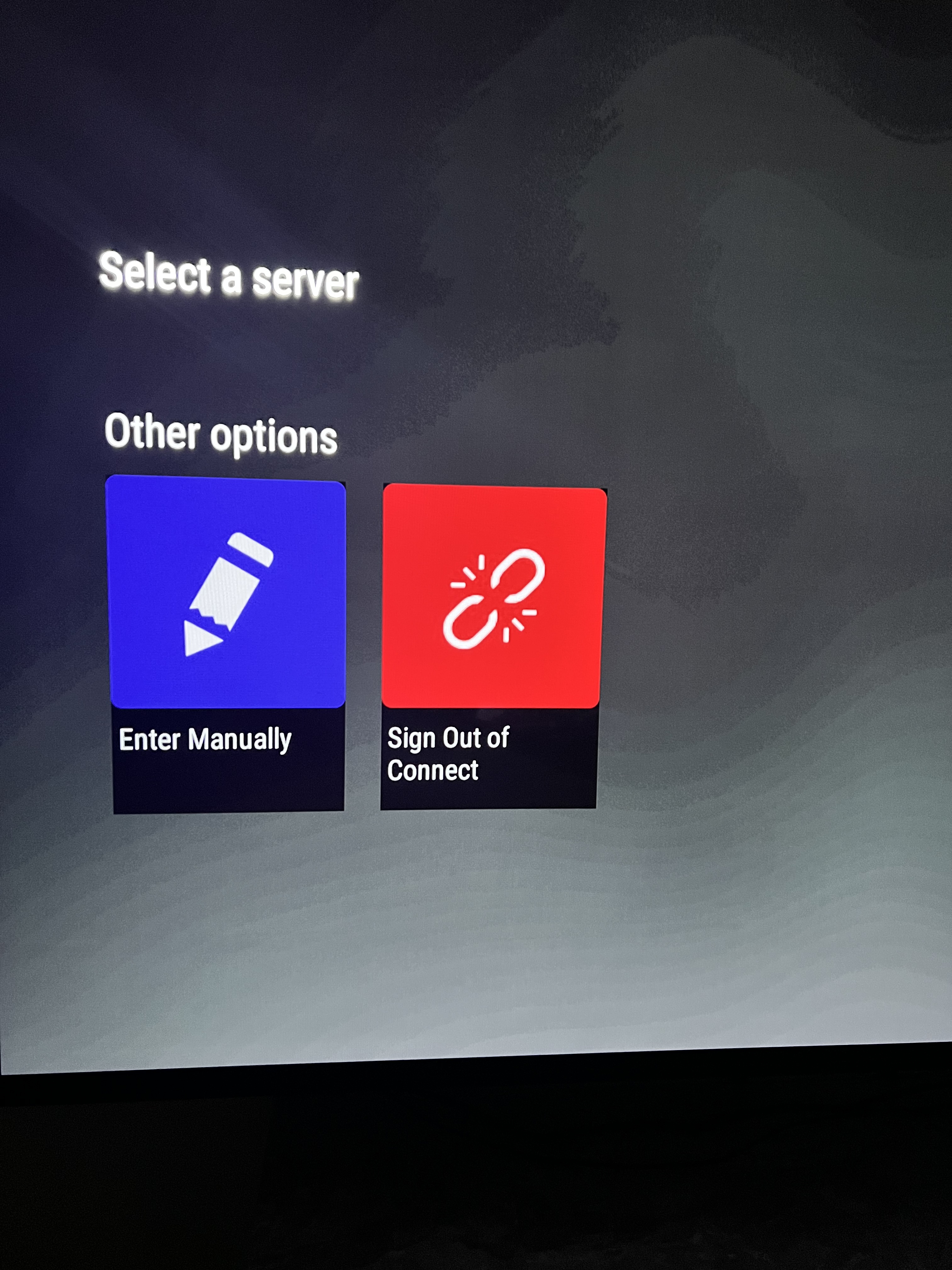

Luke 40021 Posted February 12 Posted February 12 OK so it’s that purple button to enter the server info manually is what I’m referring to. Please try that. Thanks.

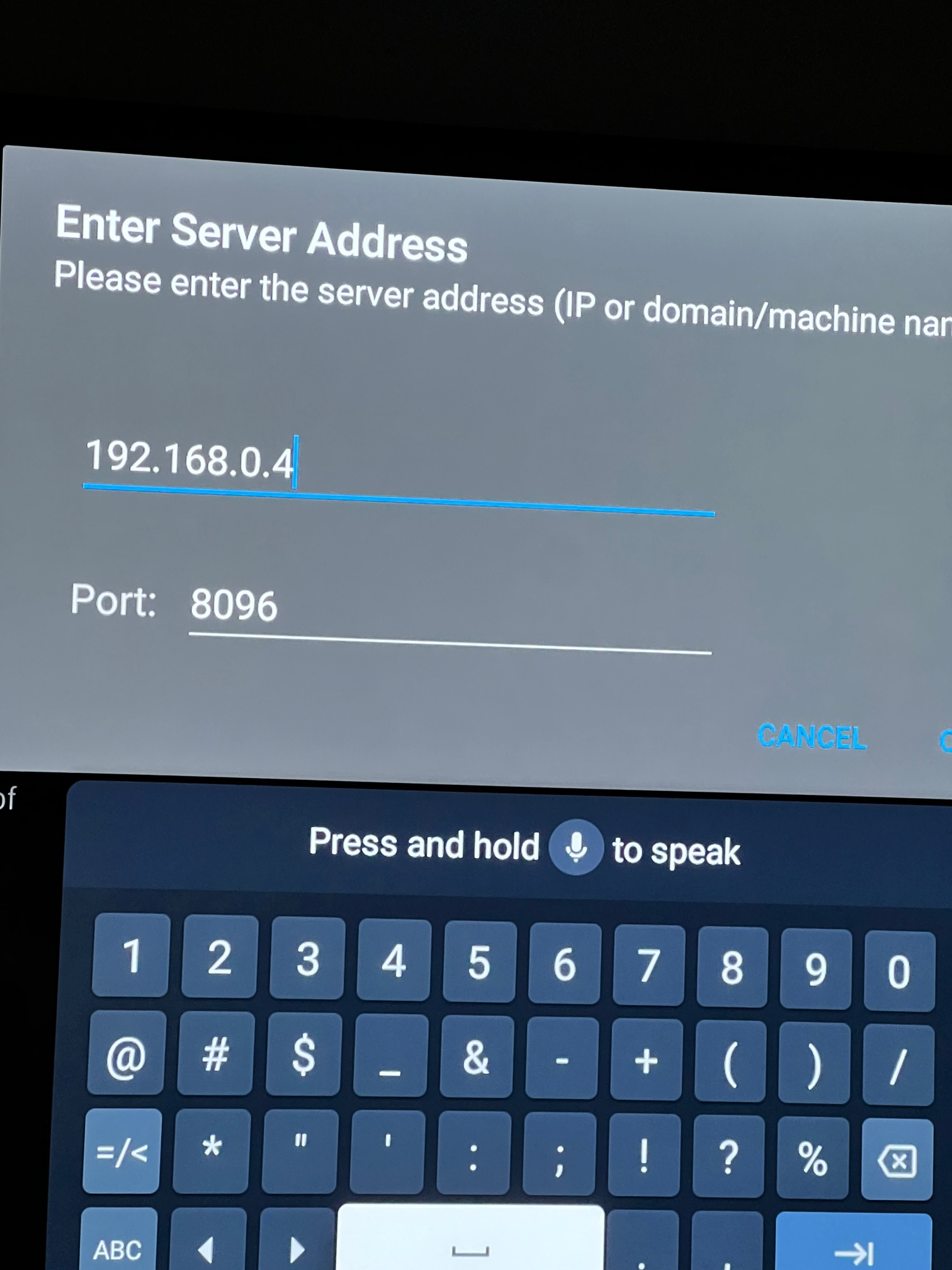

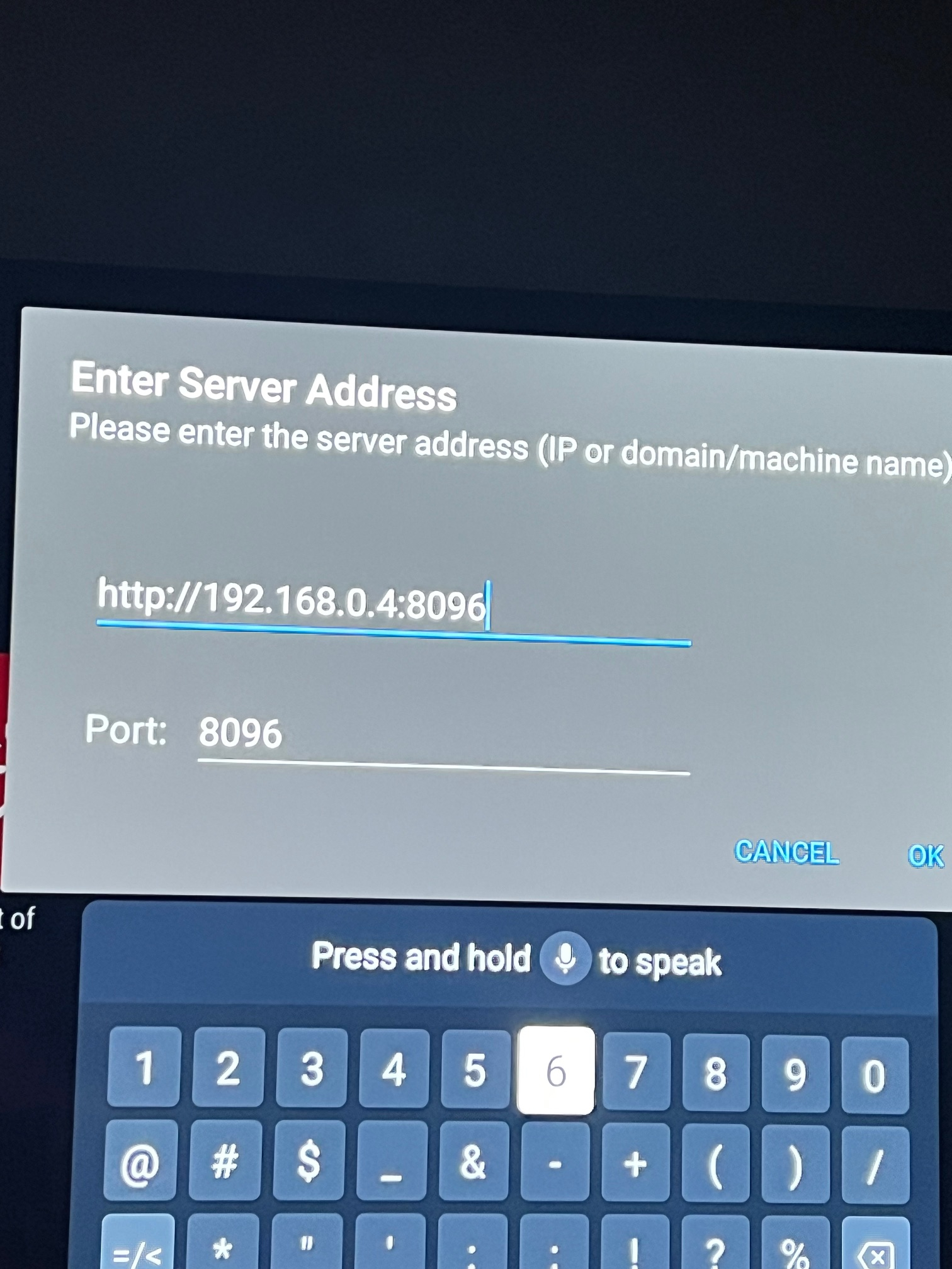

gensoto1990 1 Posted February 12 Author Posted February 12 First try: Second Try: I think it might be my MacBook Pro, tbh...

Luke 40021 Posted February 12 Posted February 12 Also are you sure the address you’re entering is the correct server address?
gensoto1990 1 Posted February 12 Author Posted February 12 57 minutes ago, visproduction said: Try: http://192.168.0.4 8096 Nothing.

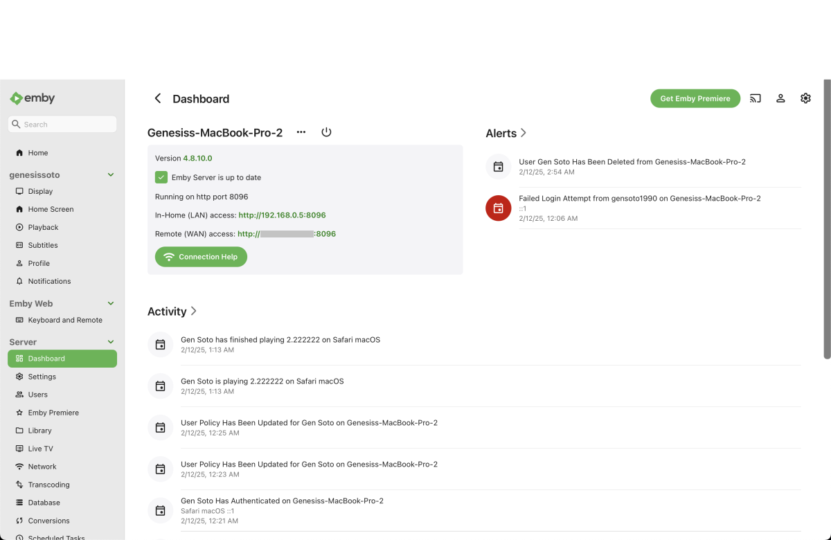

gensoto1990 1 Posted February 12 Author Posted February 12 (edited) 49 minutes ago, Luke said: Also are you sure the address you’re entering is the correct server address? Edited February 12 by GrimReaper WAN IP masked
gensoto1990 1 Posted February 12 Author Posted February 12 Can someone get in touch with me online? Like on Zoom or something? I'm ready to tear my hair off tbh
Luke 40021 Posted February 12 Posted February 12 6 minutes ago, gensoto1990 said: Can you try entering the server address again? Based on this screenshot it looks like you entered the wrong address. Thanks. 1
Happy2Play 9436 Posted February 12 Posted February 12 (edited) is your server ip address changing as it is .5 now not .4. Sounds like you need to ensure your Emby server has a static ip address. @GrimReapercan you edit the image above. Edited February 12 by Happy2Play

Luke 40021 Posted February 12 Posted February 12 47 minutes ago, gensoto1990 said: I did put the right address, because I noticed as well and yet zero. It does not let me in. And how do I put the static IP then? But you entered 192.168.0.4 and your screenshot from the server shows 192.168.0.5, right?
gensoto1990 1 Posted February 12 Author Posted February 12 I entered the one that ended on 0.5. Nothing.
