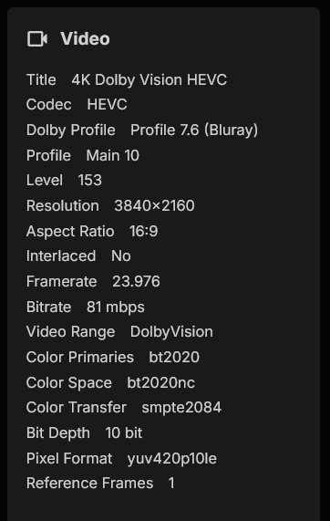

    3. Dolby Vision profile 7 files (aka DV with EL) don't seem to trigger automatic HDR enabling and look washed out. Once HDR is enabled they play and look fine.

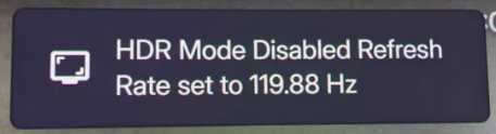

    4. Minor issue: Notification popups include escape sequences. For example: "HDR Mode Enabled.\r\n" (the \r\n is shown on screen).
Can you please show the Embyx MediaInfo for such kind of file?
Fixed in Beta 2.217.0 (released today).
It happened with every profile 7 file I tried.
Sorry, the beta was set to work like the regular release, not the plus app.
It should work in 2.218.0 now (for all codecs).

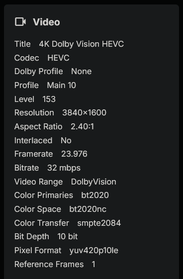

Thank you for your diligence. There are still a couple of issues to iron out though.
I found edge cases in my library where HDR is still not enabling. It might have to do with Emby server not recognizing the DV profile in these files. Notice how it says "None" under Dolby Profile:
MediaInfo reports them as a profile "8.6":

There's some discussion in this thread:

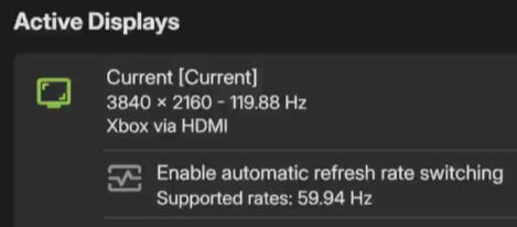

Next, the 120 hz spinning circle problem is still not completely fixed. It switches to 24 hz just fine, but it has trouble switching to 60 from 120. The TV reports being switched to 60, but there's no notification from Emby that the refresh rate changed (only HDR enabled), and you get the endlessly spinning blue circle. If you set the Xbox to 60 hz then everything plays fine.

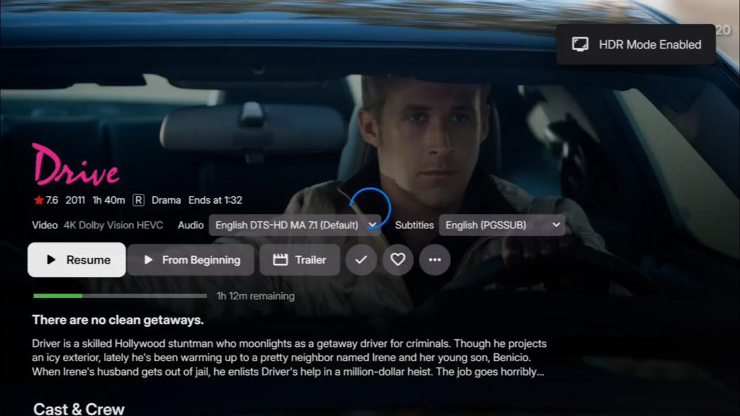

And finally, this is a very minor cosmetic issue but since I already brought it up earlier. The escape sequence is gone but there's no newline:

Ignore that last screenshot. I forgot to delete it and it's misplaced.
Thanks a lot for testing. Profile 8.6 actually doesn't exist afaik.
Can you run this on the server:
ffprobe -print_format json -show_streams <file-path>
So, the refresh rate changes but the video doesn't play?
Does it play on a second attempt then (when the rate is alredy at 60Hz? Or doesn't it really switch to 60Hz?

                    "dv_md_compression": "none"
                    "side_data_type": "Mastering display metadata",
                    "red_x": "34000/50000",
                    "red_y": "16000/50000",
                    "green_x": "13250/50000",
                    "green_y": "34500/50000",
                    "blue_x": "7500/50000",
                    "blue_y": "3000/50000",
                    "white_point_x": "15635/50000",
                    "white_point_y": "16450/50000",
                    "min_luminance": "50/10000",
                    "max_luminance": "40000000/10000"
                    "side_data_type": "Content light level metadata",
                    "max_content": 4809,
                    "max_average": 1138
Yes, the refresh rate changes, according to my TV, but without the Emby notification that usually accompanies a refresh rate change. Then it just gets stuck like this:
The app becomes unresponsive to my inputs and the only thing I can do is force close it or wait until it crashes after a few minutes (varies), so I can't test a second attempt. It also plays all SDR files at 120 hz without attempting to switch, which play fine as we know (only HDR has issues with 120 hz).
