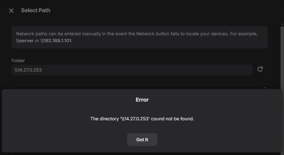

I was extremely excited to move my files over to my new Ubiquiti UNAS Pro, but after setting up my shared drives and testing them on my Windows 11 unit, I was unable to connect through the Emby server.
I've checked a ton of forum posts about samba shares and file access but all attempts were to no avail. For reference I am running the EmbyServer / embytray setup as opposed to Emby as a Service.
My only thought would be that the samba share is accessed by the "Connect using different credentials option", where I then pass credentials stored in the NAS:
The Emby Log Provides the following message:

    MediaBrowser.Common.Extensions.DirectoryUnavailableException: MediaBrowser.Common.Extensions.DirectoryUnavailableException: Directory not found: \\14.27.0.253
       at Emby.Api.EnvironmentService.Post(ValidatePath request)
       at Emby.Server.Implementations.Services.ServiceController.GetTaskResult(Task task)
       at Emby.Server.Implementations.Services.ServiceHandler.ProcessRequestAsync(HttpListenerHost httpHost, IServerApplicationHost appHost, IRequest httpReq, IResponse httpRes, IStreamHelper streamHelper, RestPath restPath, String responseContentType, CancellationToken cancellationToken)
       at Emby.Server.Implementations.HttpServer.HttpListenerHost.RequestHandler(IRequest httpReq, ReadOnlyMemory`1 urlString, ReadOnlyMemory`1 localPath, CancellationToken cancellationToken)
    Source: Emby.Api
    TargetSite: Void MoveNext()
Obviously the main concern here is "Directory not found: \\14.27.0.253".

Have you tried manually typing full path for particular library, i.e. \\14.27.0.253\Emby\Movies?

Hi, that is the server. Try typing in the network share, e.g. \\ip\emby
Hey so I got frustrated and took a break from the setup - I restarted the NAS, Server, and EmbyServer numerous times with no luck.
I ended up testing Jellyfin (which is just a fork of Emby) with no intention of actually switching and noticed the connection worked immediately.
Afterwards I restarted Emby and thus - the connection began to work.
I believe the logs show I tried \\ip\Emby, as well as the directories like \\ip\Emby\Movies as well - although when it worked it was first try just typing in the UNC path as I had before.
Thanks for taking time to look at this and I hope no one else has trouble with their setups : )
